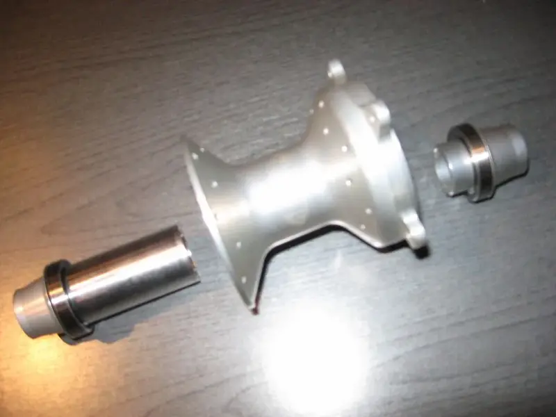

Mine is just a tube, the axle runs through it and the bearings just interference fit to hold it in place.... It can wiggle up and down in the hub shell if you take the axle out.
The top hats are asymmetrical, one side is slightly longer than the other so you can space the wheel to accommodate the brake calliper....
I'll pull it out and take pics for you but you don't have my kit in any of your pics....
Im unsure if the tube ,with the bearings and bolt through spacers are big un :? but is that what you meant by the 'tube' or do you mean it looks like the bulb QR converter (only i think its extended both sides to the bulbs disc side only :?)
MrP sold a similar one to the top slid axle with the red spacers, and its where i got the idea this was big un and not tandem or something the chap made himelf.
Bottom 2 im thinking are the big un solid rear and the cut down for the No2 caliper ,just basically as theyre the same diameters as the front and look very similar.

The second one down is the same as my kit, minus the rubber ring around the centre....
The top looks like the big un qr kit I stupidly sold a few years back... Minus the bearings of course ...

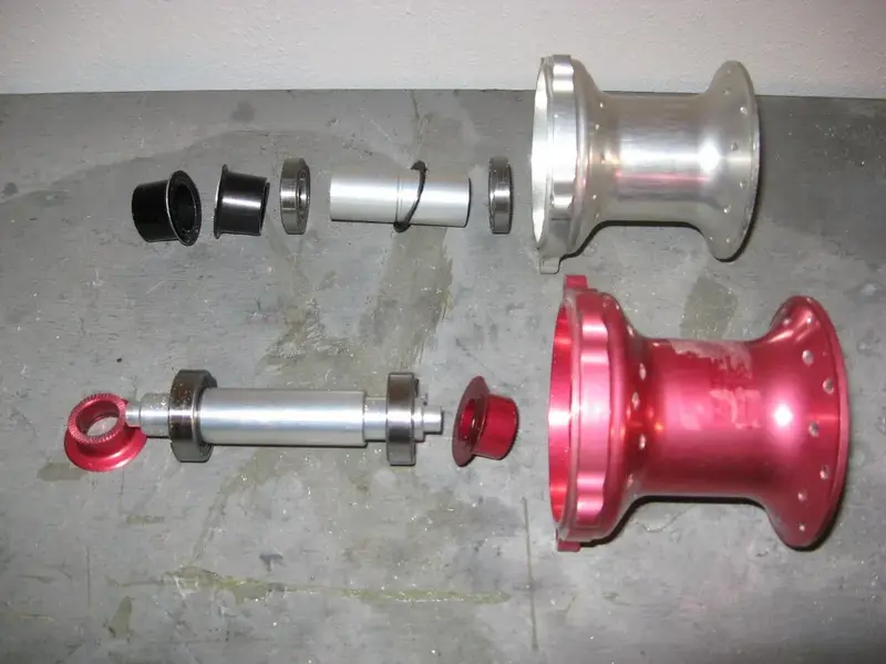

Speaking about just jacques's images, I have some front BigUn hubs.
In this image, you could see what I call a Gen1 BigUn: fat hub centre, the red is QR, the silver is 20 mm. As you can see , this silver one has two top hat adapters, plus the bearings are pressed directly into the hub's sides, and a spacer tube fitting snugly between the bearings. In fact, I converted the red QR one to 20 mm by buying correct bearings, plus two Bulb 20mm top hat adapter, and carefully cutting a 20mm ID alloy tube ( seatpost) to the correct lenght.
In this image, you see what I call a 2nd gen Bigun ( slim hub centre): the adapter is much more comlex: two conical side adapters, bearings on a shoulder of the adapters, all the asembly fitting INSIDE the center tube.
Hope this helps.

I put the O-ring around the tube as my others have them and theres a little bit of a groove there too. Stops the inner support tube from rattling about annoyingly .

Dynati, by looking at a bulb exploded view ( bulb should stand for Big Un Little Brother, in rather typical Hope-esque lingo) i became persuaded that the two bottom axles in your last image are QR rear Bigun axles.
If so, they would not suit me: i'm currently looking for a way to convert my Qr rear hubs to 135x12 solid axle.....
