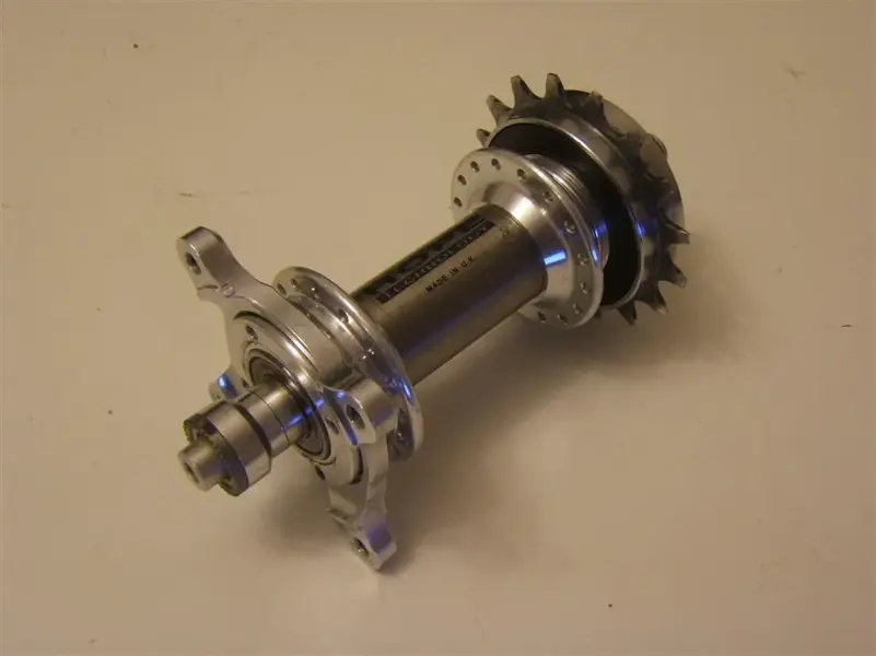

Amongst it all was a nice new screw on rear, in 135mm but with a disc mount and a 4 bolt rotor mount to boot. Thought i knew Hopes history :oops:

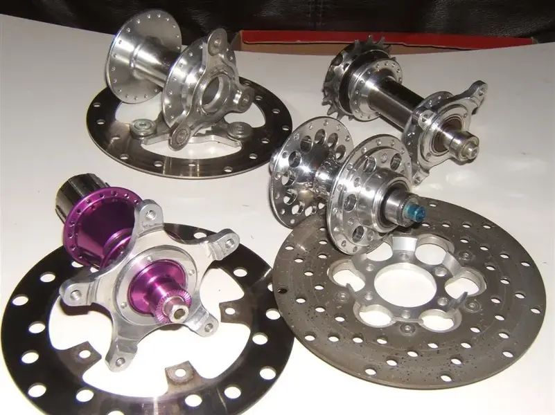

Interesting the rotor mounts from over the years :? Starting ( I think) with 6 bolt, though not todays pattern,on to 3 bolts with the original floating rotors, then to 4 and then to 5 , culminating in the 6 mounts we use today. :?
The 6,5 and 3 i knew about.Was totally blown away to find they did a 4 bolt rotor mount.

You mentioning that the three arm rotor have a floating disk demanded me I have question about the threm. Is there supposed to be a serrated spring washer either side of the disk, or just on one side?
I have one but it has been in a box for years and when I came to put it together the other day I had 4 of the serrated washers. Just wondering if I have one too many or two too few?? :?: :?:
If it's the latter, I don't suppose you have any spares do you? :D
Both sides.
No spares no :) But they do strike me as being or looking like rather, the type readily available in the engineering trade. :?
Given Hope and the rest were new to this whole disc brake thingy and so that makes me think they werent custom made for this project :?
Could be wrong but im pretty sure if you looked about at engineering spring washers at that size you'd find a vast range :?
Ive a spare one of the spiders, came with the rotor worn so thin you could use it to slice bacon :lol: , every bolt rusted on and after i did get them off the washers were rusted and falling apart, the other 2 i have are near new and unlikely to ever suffer that fate.
