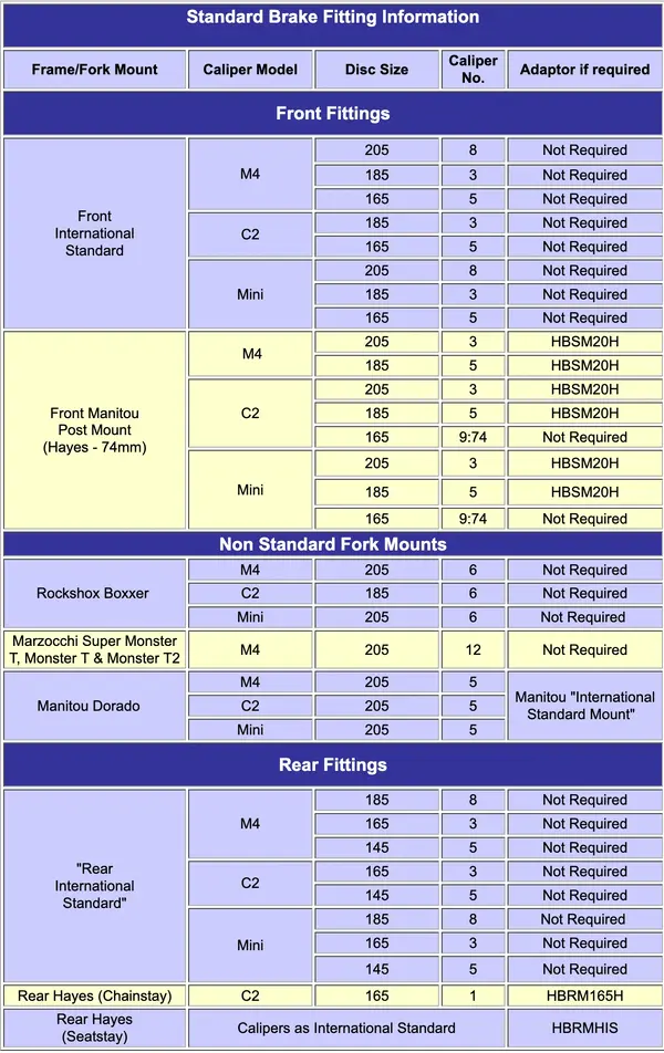

Wanted Hope C2 205mm 6-bolt rotors
Couple of issues there, the C2 was generally 5 bolt because they were 94-98/99 ish and normally ran 155/165/185. The 205’s came in right around the switch over point on C2 and Enduro4 in 99/00/ so I suspect not many out there. I know this because I had to ditch my C2’s and switch to E4’s on my 01 Boxxer so I could run a 205 rotor…
Hope may make you some from spec if you ask them nicely
Cheers for that! Actually I didn't have any trouble finding 6-bolt C2 discs in 185 and 165mm. I even found a couple on ebay.co.uk today. As for the 205mm, I was guessing that they are quite rare but did some searching around with the waybackmachine and found some leads that they were produced around the time the C2 was discontinued, so around 2004/2005, at least. Found this brake fitting info on an old version on the website, which lists the 205mm as an option for some caliper/adapter configurations.
I would consider getting new ones in the end, but the ones offered on the net I found so far don't have the original design, lacking the cutout on the arms close to the bolts. Haven't tried to ring up the guys at Hope though, amazing customer service and super helpful!
