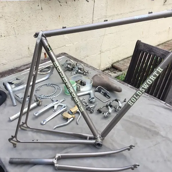

So I couldn’t wait to give a strip down and start cleaning it up , I’ll be using all the original components again apart from new bar tape, brake pads and possibly tyres oh and also hoods if I can find some decent ones ??

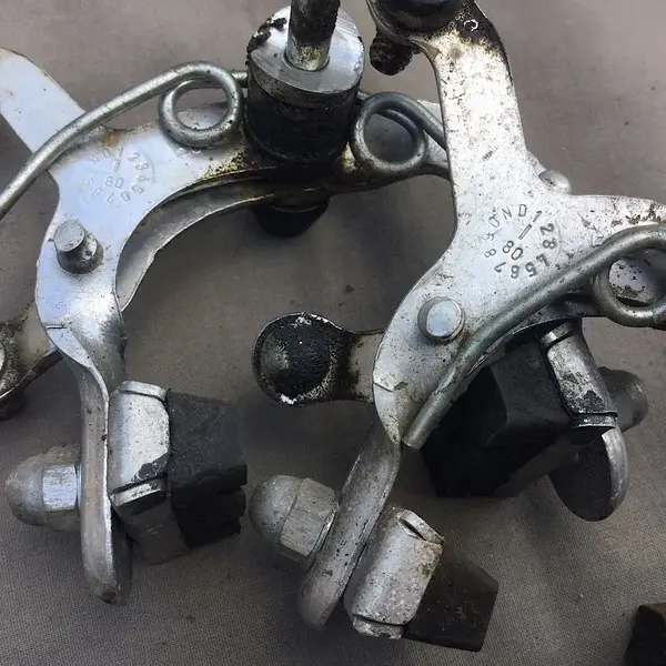

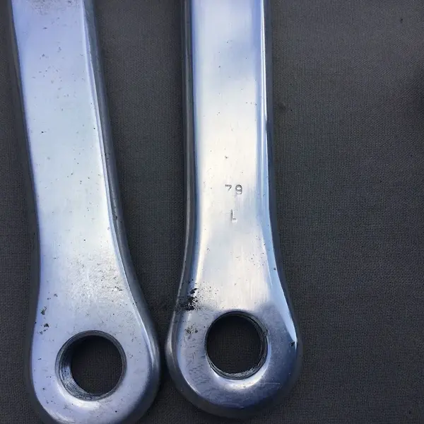

It’s coming up nicely , there’s a couple more dates shown on the crank arm and Calipers

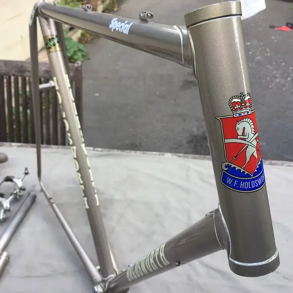

Im in two minds wether to try and remove the lug lining which the previous owner done , he also added his initials MW on the top of the rear seat stays.

Nice when the dates align isn’t it? December ‘79 for the cranks, January ‘80 for the braked & a 1980 frame prediction.

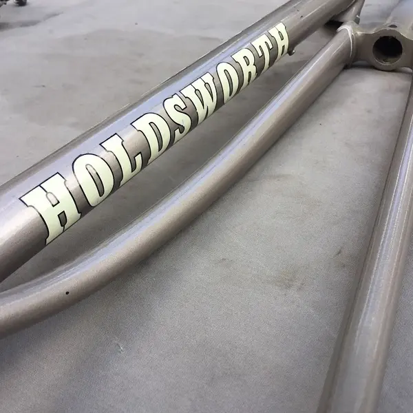

I think I’d T-cut the lug lining and replace the special sticker with something a little more stylish from H Lloyds cycles. (It’s the wrong style, wrong colour and it’s on wonky)
Yeah I was dubious about those special decals , I’ll get the correct ones , and yes I’ll give the lug lining a go with t-cut , it’s nice to get things back to orig. :wink:
That's a nice collection of components too- Campag seatpin (or SR copy?) SR Royal cranks and stem, Crane rear mech, Milremo Pro saddle..
