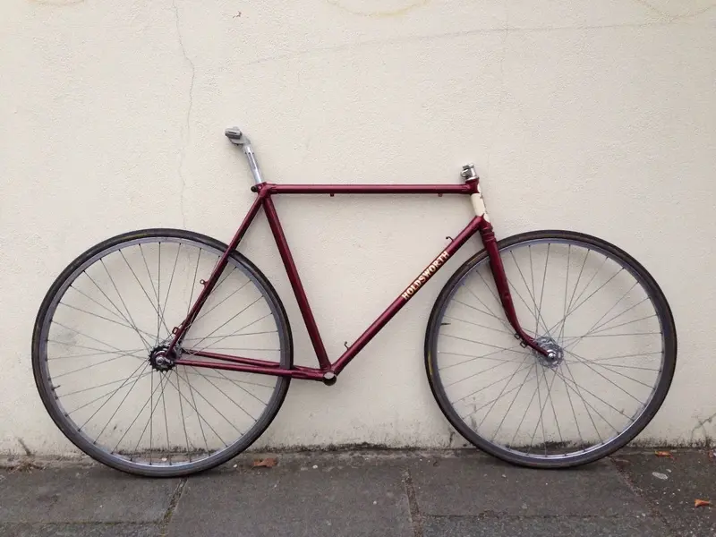

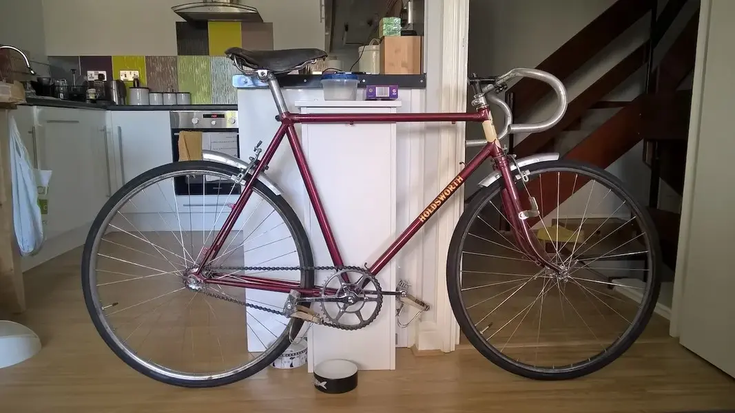

For what is worth I own a Holdsworth which the VCC current marquee enthusiast identified as a La Variable from 1939.
The serial number on the fork steerer states: 6015
On his e-mail he stated:
This is almost certainly a 1939 built frame and is identical to the La Variable model shown in the catalogue of that year. I suppose that it could have been retailed either during or after the war and may not have had a headbadge due to the shortage of materials during the war. Bearing in mind the international situation, 1939 would not have been a good year for sales of frames. Numbering of Holdsworth frames was sequential beginning in 1933 so the idea that No.6000 coincided with 1946 is not in my view correct, though many frames in the later 6000s would have been built and retailed in 1946 or 47
Here are pictures of the frame built up with components from later times:
https://www.flickr.com/photos/anidel/al ... 6205155488
Hope this helps.
Hope this helps.
Thanks for this, I had spotted this on the web/flicker and logged it, good to see more pictures.
This is a key number being pre-war and 6000+, I also have a low 6000 number that is reported to be purchased in 1948. It has the same pre-war headset as yours which should have been used up during 1946, see nkilgariff site. So it was either a late sale or incorrectly dated on the website. Either way I believe it to be from the start up period after the war so the two numbers nicely straddle the war break and help fix the prediction chart.
Thanks again for the up date.
