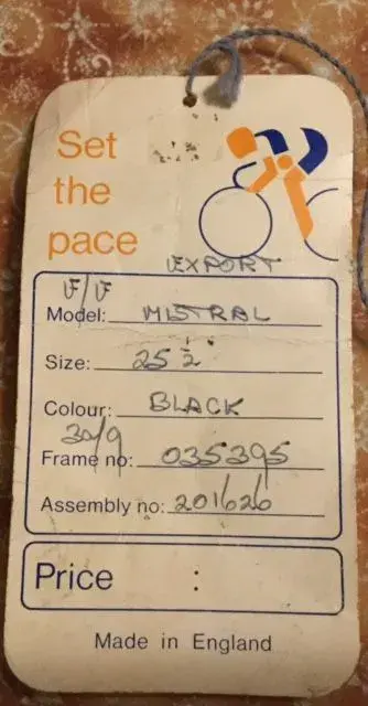

My black one is serial number 035395, and I have the original hangtag from it still.

Hi Doug and Dave - I worked at The Trail Shop in Halifax NS Canada from June 1981 until 1995. I began as a mechanic and worked up thru sales staff to buyer. But by the time I became the buyer, the shop was no longer ordering framesets from England. My ex-boss Greg Smiley ordered the framesets. They had already placed orders prior to my arrival so began importing in 1980 or possibly 1979. My 25 1/2" Mistral arrived in a shipment of eight or ten framesets, including some Professionals and Specials and Mistrals. Later shipments included some Elans as well, I think in 1983 possibly.

I can't remember the month of arrival of the black Mistral but it certainly was 1982, not '81, but whether it arrived in February or March has disappeared into the mists of time. I was certainly riding it in April 1982.
