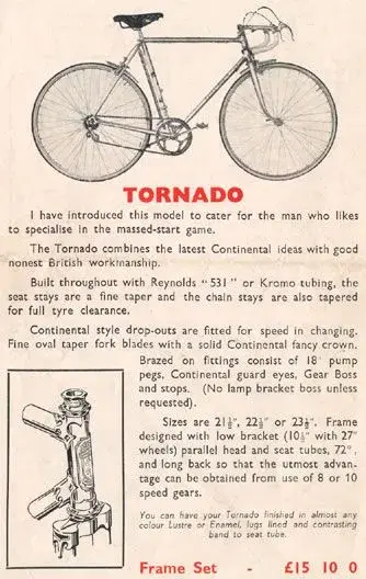

I'd place this as a c.1952 Tornado with what I would think are modified continental Ekla lugs. Pretty much same as frame 16503 on Dave's data base, although yours has somewhat different treatment of fluted top eyes and pump pegs placed on left and towards rear of seat tube as shown in Tornado catalogue page pirated from Kilgariff.

Thanks Doug, it certainly looks about right from that catalogue scan.

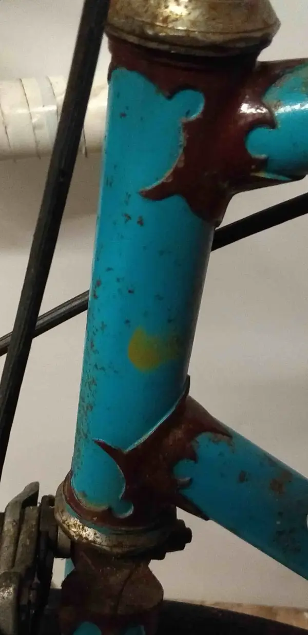

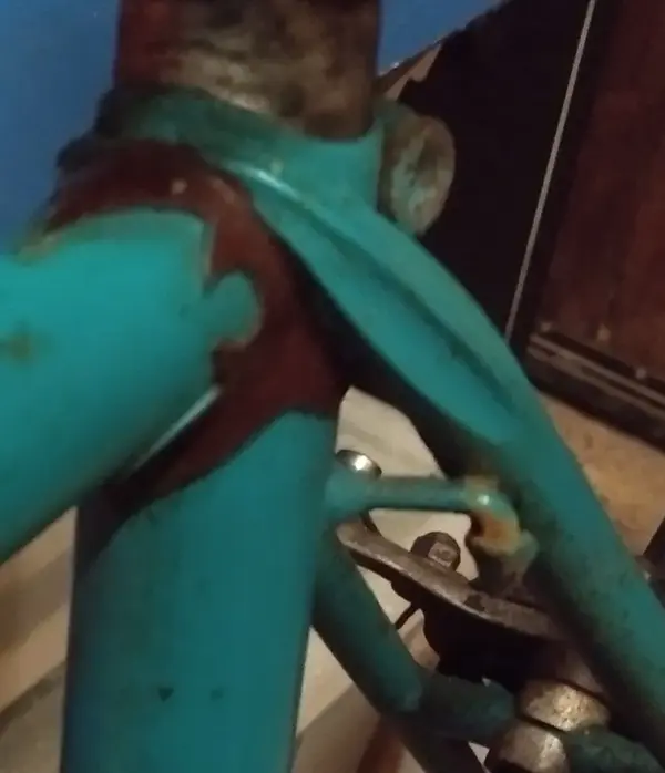

I have just purchased a Holdsworth bicycle. It's very much a 'bitsa' - some original parts, and some more recent. I'm trying to date the frame. The bottom bracket is stamped 'Nervex' and it has the serial number 1203. That number also appears on the fork steer tube. It has fancy lugs and brazed on pump fittings, right side gear change fitting and a small wheeled guide for the gear cable. The drive side dropout has a derailleur fitting. The fork tube has no drillings for a head badge. Various photographs online would indicate that it is a Typhoon, but the serial number would be wrong for a late fifties frame. Also, I'm not sure that a late fifties frame would have the derailleur fitting. Any ideas?

I trust others would join in here, but for an opener I would go with early 60's then holdsworth were using 4 Digit numbers. Not sure of modle, but if you open the excel database and follow the links for frame numbers 2391, 1492 & 609 these seem to have the Nervex head lugs and no badge. #2391 looks the closest. not a lot on the history site for this period, trust other can add to this on the ID.
