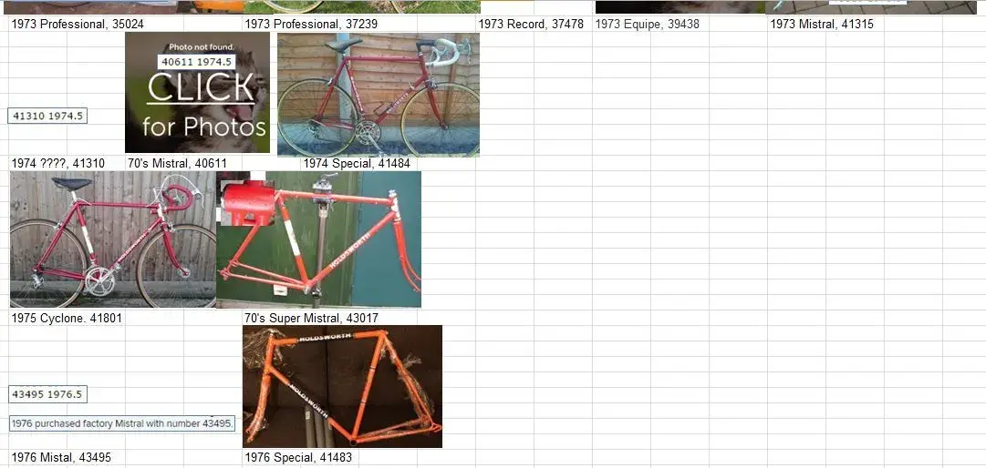

Thanks, I had this down as a 1976 Special along with some others around that time, including the frame number 41483. These are both mentioned on page 2 of this thread. Am I right to keep these as tail end of the post war 5 Digit system. It could be the latter decals have been added, but I thought 70's would be too early for 531C. Any thoughts?

Thanks, should have added the picture below, what do you think about the other mid 70,s frames?
By chance, is there actually a 0 in front of the 41483 for sale, thus placing frame in early 80's? I've seen the lowly zero neglected in the past, thus adding to the confusion.
Having both 41483 and 41484 would appear to be a gift from the gods, except for the fact that 41484 is overflowing with anachronisms- it is either an 80s frame with a '70s lugset, or a '70s frame with '80s paint, decals, and braze ons. Like most gifts from the gods, it turns out to be not much of a gift at all! (I am using the terms: "'70s" and "'80s very loosely!)
How about this: Let us provisionally wildly speculate that, for whatever reason, 41484 spent a few years knocking around the Holdsworthy premises in an unfinished state. Later on, in the "'80s", it had braze ons attached, paint and decals applied, and was released onto the market?
The 'gift from the gods' part is that, if there is any true sequentiality to the numbering system, these two frames were likely built the same day. The vendor of 41483 is not insisting his frame is from any given year, and the vendor of 41484 seems to have abandoned insisting his frame is 1974 (or before).. why not split the difference and (provisionally) put both of them at (early?)1975?
