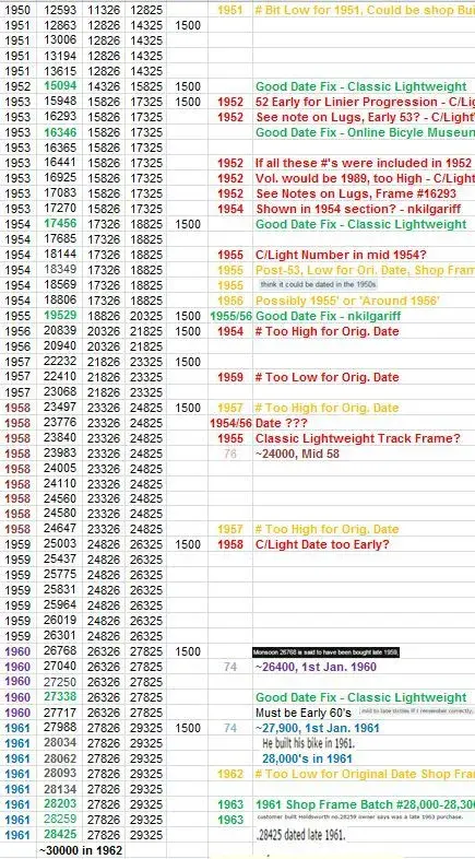

Holdsworth Frame Numbering
Finished Running over the dates again and added comments on validity.
Best to summaries this a s a prediction of factory numbers using a linear progress to hit known fixed points and good date fixes. See below. (Rising production after 1976)
Assuming production was so stable for so long, seems odd, accuracy would be around a year or so either way. Shop built frames will be out by up to 2-3 years.
I think this is as good as it will get just working off online info and there does still seem to be some issues early 50's and after 1976 the dates are rather vague at times. See comments in spread sheet.
Graphs and full spread sheet on Google drive
https://drive.google.com/drive/folders/ ... TNKZkN4TmM

I can add frame number 15584, a Cyclone, which seems to put this in 1952, but I have no separate evidence to confirm that date.
I tried to download your excel file, but it seems rather large at 57Mb and my AV system complained about it. Can you check and maybe repost?
Jay.
Thanks for the number I have added this to the file. Yes the excel file contains a pictures of each frame so is quite large. I have added page two only that has graphs and numbers in year range. hope this helps.

Hi again,had reason to look at the late 60's graph again as an other good date/number came up, see elsewhere in the thread. I have now put it back in a linear progression and places your bike back a bit further. Accepting the accuracy can be out by a year or two I now make yours end of the 60's rather than 1970. Hope this helps rather than a disappointment.

I am trying to find out how old my holdsworth bike is the frame number is 52 63 with the forks 38814
could this be around 1977 ?
Did you look at the 'new thread' linked above by dwcrimshaw? The first post has tables. They might not be the latest iteration, but their location (in a twenty-five page thread) makes them easy to find!
Consulting those would suggest that you have a circa '72 fork on a frame that could be a few years later. If the numbers don't match, it is, afaik, unlikely that the frame and forks are an original factory pairing.
Do you know what 'model' your frame is? Is it 531DB with Campag. dropouts?
Any particular reason for expecting it to be 1977? Both the 4-digit (your frame) and the 5-digit (your forks) Holdsworth factory numbering systems are assumed to have terminated before 1977 in favour of the new 6-digit system.
thanks for your reply and you help the frame paint is in very poor condition so i dont know which model it is i have cleaned the paint it also has DC stamped near the frame number
