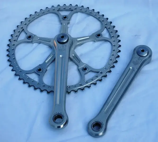

So off we go, I earmarked a Campag Super Record Pista Chain set with a 54 tooth chain ring and after a little sweat I drilled the chain ring to save the odd gram. (Weight 544g inc bolts)
A Super Record Titanium BB was fitted, but alas was too long and the chain line would be wrong, a shorter Super Record (257g) sorted the Chain line out, but was heavier. Bummer, I could have saved 70g.

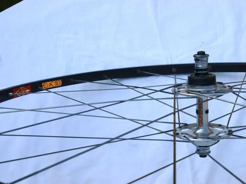

The wheels, large flange was all the rage at that time and the only pair I have are 28hole Suntour Suberbe large flange hubs laced to Mavic CX18 rims with some early aero spokes, weighing in at 699g front and 769g rear, without skewers. Another search in the spares bin, I found an old FT skewer and a Roval skewer that were much lighter than the original Suntours, (122g).

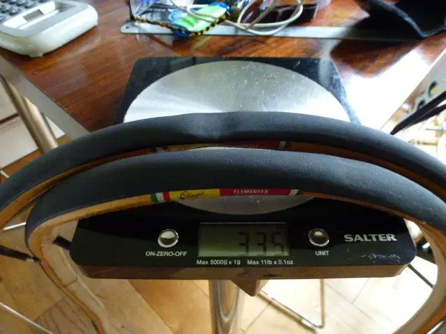

A great saving on weight can be made with the tubular and these Clement Clementex come in at 335g for the pair. If anyone know anything about these please let me know.

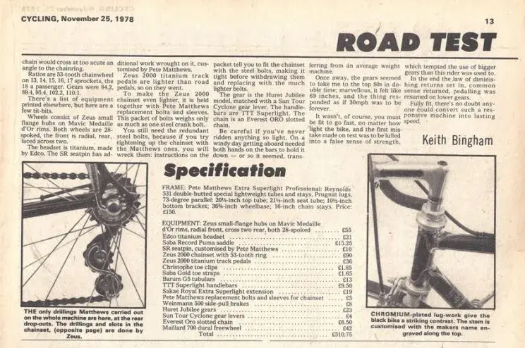

In the mean time I found this article in a 1978 Cycling comic, somehow the numbers don't add up!

57 ring was the standard of the top guys like Cotters, Engers, Adkins, Queen. Pyne & Cammish used 56 rings & all had 12-17 blocks.
Nice 54 ring but I'd still the holes bigger. You could use an OMAS Ti BB as that was the choice of the day.

Yes, it would be desirable to have a 57 tooth chain ring, but this one will have to do. I will see if the drilling of the 54 tooth can be made larger, Nob, what size holes do you advise?

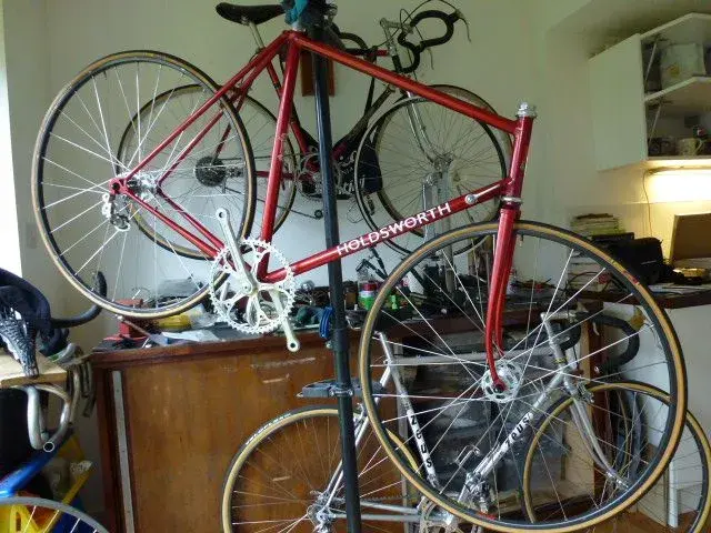

All comments welcome, the build so far.

As for drilling here is my 54 ring & I think I used a 5/16" drill maybe 1/4" on your ring.
This ring has since been replaced with a 57 ring :)
Andymart, For drilling the chain ring, I did cheat and used an old 54 chain ring that had been drilled as a template, then fixed them together on a piece of MDF and using the old ring holes to drill through.
Nob, I have just measured the drilling and when fixing the two rings together they were not exactly the same and the alignment of the holes are not centred perfectly as a result I only have 1.8mm of ring left on the inside edge. Making the holes larger may show this error up and weaken the ring? Food for thought.

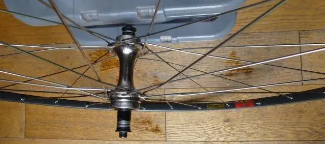

The FT rear hub is presently laced to a Mavic SSC rim, the nickel plate is peeling off the hub. I have a replacement hub shell and will rebuild it one day. Interestingly, this wheel weighs the same as the Suntour/Mavic CX18, both are 28hole so the extra SSC rim weight must be the same as the lighter FT hub.

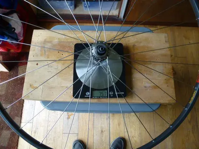

As the weather has been awful this week, I spent some time polishing parts for this build and found time to rebuild the FT hub and remove a spare CX18 rim from an old wheel.
The new wheel was expected to be much lighter on paper, the CX18 rim should be much lighter that the Mavic SSC, however the new wheel weighed in at a disappointing 758g, this is only 12g lighter than the planned wheel. The SSC rim was much lighter than the info on Velobase and the CX18 a little heavier.

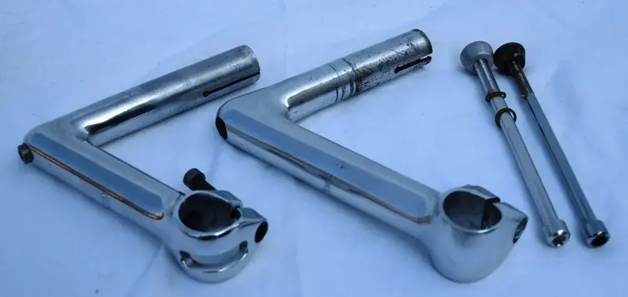

The bars to be used are 3TTT Competizione (300g) and I have a choice of stems, if the 115mm SR Ultralight (187g) is too short the 140mm Cinelli with the alloy stem bolt (308g) will be fitted. I will tape the bars with classic cloth tape from the brake levers down (I may dress the brake levers as I do like to use them for riding when not racing) and use an old wine cork to finish them off.

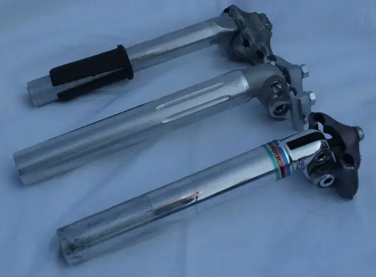

A matching SR ultralight seat post (216g) is preferred over the Campag SR (252g) and the ITM Aereo (22mm) with sleeve to fit 27.2mm (242g). I did try to use the titanium fitting from the SR on the Campag to see if any weight could be saved, but alas they did not fit..

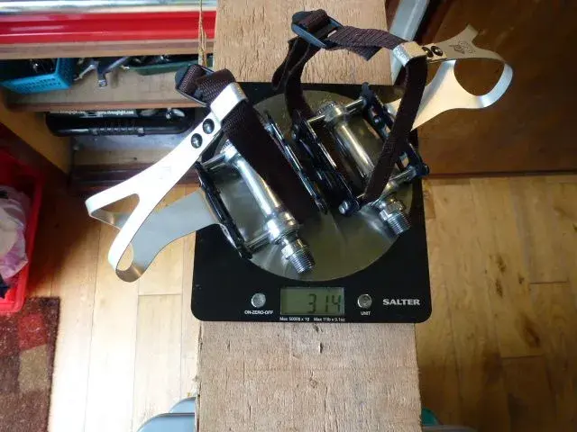

I have already removed the pedals from the Chesini and replaced the toe clips with some Ale alloy ones, I hope to soon receive a pair if Christophe alloy that may be lighter. The straps are unknow to me,(they came with a old pair of Italian toe clips that had been painted) they are nylon with a nylon clasp that allows for tightness adjustment. (314g)
