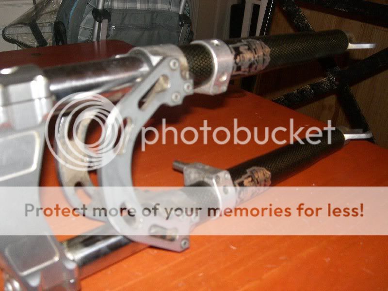

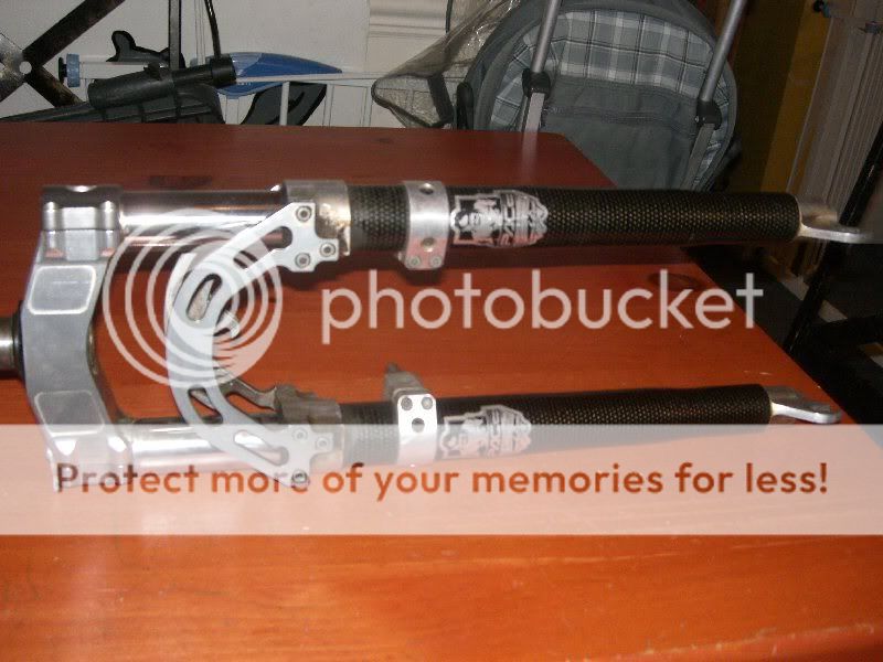

A few picsof my RC35 MXC's
[/img]
SLIM....exactly the same as these. Those are 1994 RC35 AB refers to atmosphere balance A disc that went between the two elastomers with a horizontal hole to allow the fork to breath via the central rod/ retaining screw each leg had one. You should have two elastomers 50/55mm long in each leg with the disc in between and a small 13x20mm elastomer under the head of the rod/screw for rebound control. In late 1995 the RC 35 monobox was introduced they do not use elastomers they use what PACE called MCU's similar to MANITOUS in size and a very different leg assembly to the original RC35........hope this helps

they do have the small disc with the hole as described
defo has the two elastomers , but.... it did have a third which turned to powder
as well as the smaller top out / rebound elastomer
MCU and elastomers are the same thing , just an " upgrade " 95 style
give it a new name and its an " upgrade "
better explanation .....
with the two elastomers in place and the small top out elastomer in place
there is a gap on the rod of about 27 / 28 mm
so there must be a third , f**k i wish i could post pics :twisted:
SLIM whats the screw/rod made from the original was some type of Alloy To get more travel someone may have made a longer screw/rod and added half a elastomer On the original set up when assembled you should have from top of leg under crown to top of outer leg seal 50/55mm
top of seal to crown is 90mm
and the rod is alloy and looks original , non removable from stantion
