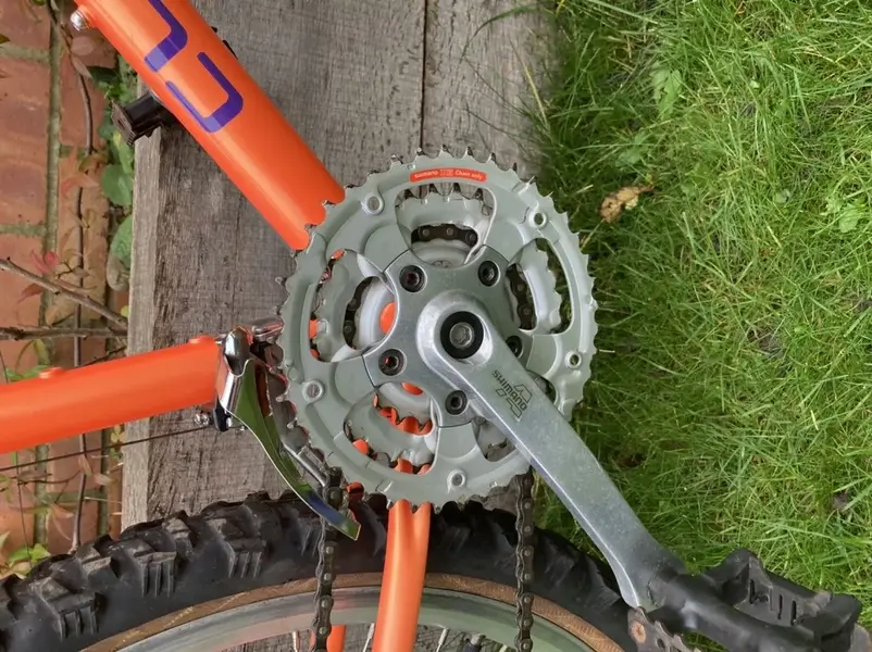

Well....that Alivio crankset is classic C16R fitment - very in-period for a nice early C16R build. WHat size frame are you looking for?
And re BB - it will be square taper and UN51 or 52 probably, so you will need a crank extractor and the big Allen key for the bolts...then a serrated cup tool which fits INSIDE the two end caps - eg
https://www.amazon.co.uk/Pasway-Extract ... B01M4IUXHF
The best way to get the BB out still is to clamp the tool in a vice and turn the frame around the tool - if you have a bench vice which will allow this.
Then the issue is getting the right length BB axle - your donor bike may or may not be the right length - but probably just trial and error....put the donor one in and see what the chainstay and bb clearances are....

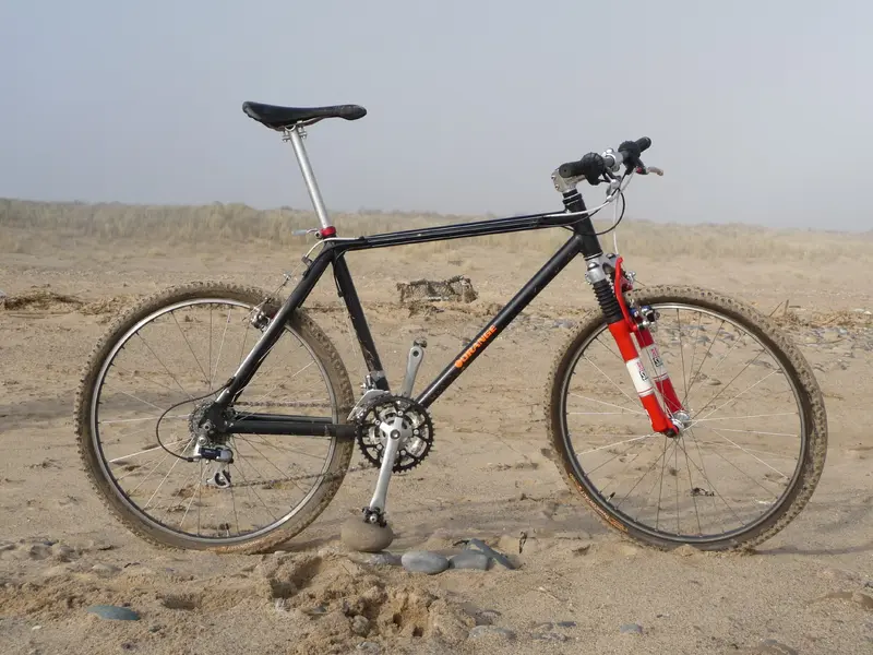

I wouldn't say they come up small, my 18.5" Rocky Mountains are too small for me, but 19" Kona are good, 20" being much comfier, if a little long sometimes.
My old Alu-O bike a few years or seven back for reference.
