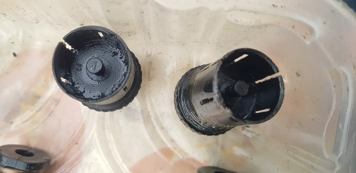

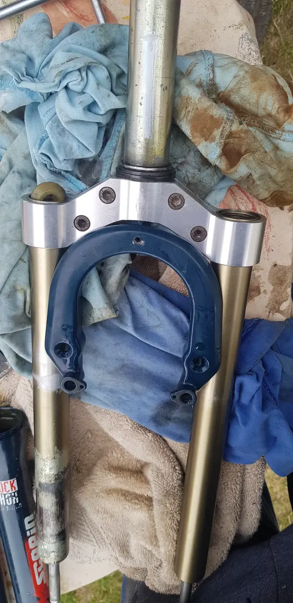

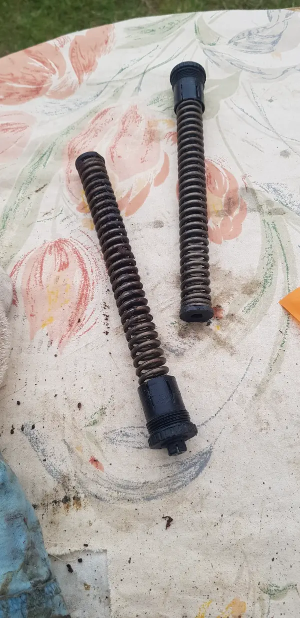

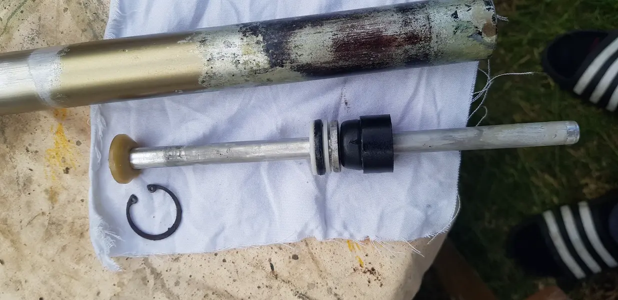

Hi, trying to service this Rock Shox Rake 44 (that's what's stamped on it).
I got so far as removing the springs but stanchions won't come off.

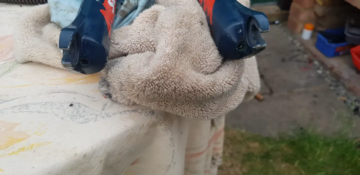

I tried re-insering the bottom bolts and tapping them but nothing.
How do you take this apart???

You need to do as you've already done, bolts back in lower legs into the dampers, enough to feel confident you won't damage the threads but with some room for the bolts to move towards the legs. I start with a small space then after a hit or two and movement, unwind the bolt a bit more and repeat until free. Repeat both sides.
Allen key in the bolts then hit the Allen key with a hammer. It can take more of a hot thet you think to break the taper fit.
Looks like a Judy with a scapin crown.
