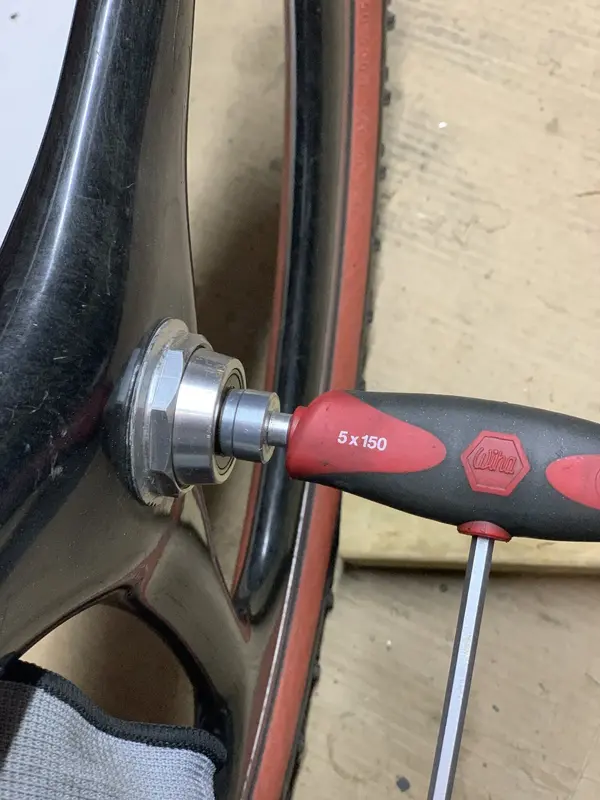

To start you need to unscrew the end caps from the axle using a 5mm hex on both sides. This one was stuck fast so it took a couple of sharp cracks to free up one side.

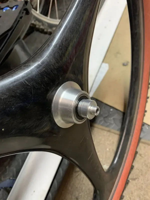

The other end cap was stuck in the hub, so I screwed the newly freed cap back in slightly (about half way) and tapped it free using a mallet and hope hub support. The end caps both screw into an alloy axle. Drifting the axle out also pulled the bearing out with it.
N.B.You need to remove both end caps from the axle. You won’t be able to remove the bearing with them in place.

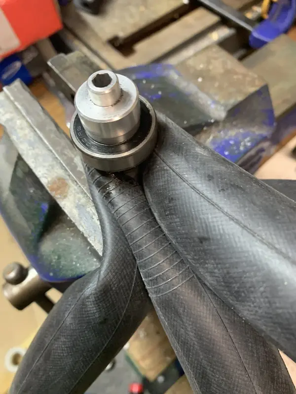

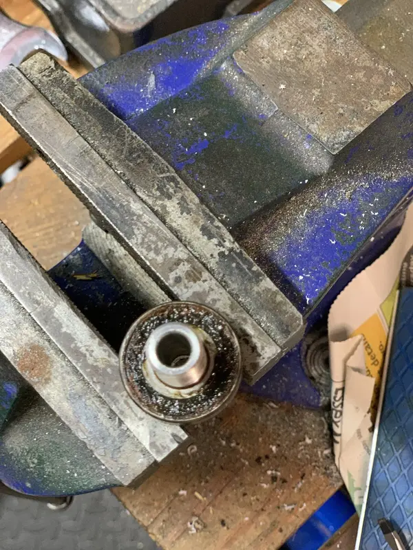

Annoyingly, the other end cap was seized in the axle so it needs freeing using the vice which scored it slightly in the middle. Again short sharp cranks to snap it free.

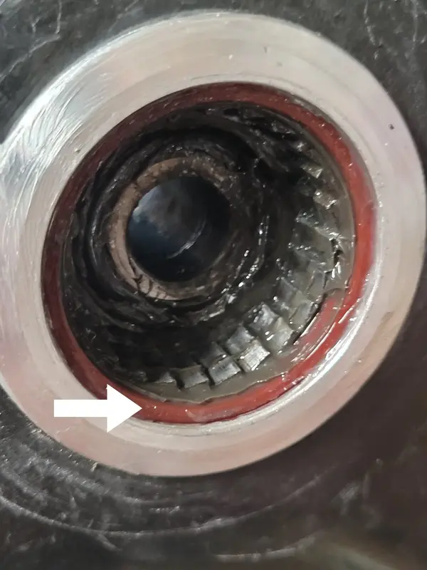

Then drift the axle away from the bearing. And slide hammer out the other gunky bearing from the hub shell….yuk!
Clean up the hub and install your fresh 6001’s. I’d go for NTN or SKF but be careful of fakes on eBay etc…

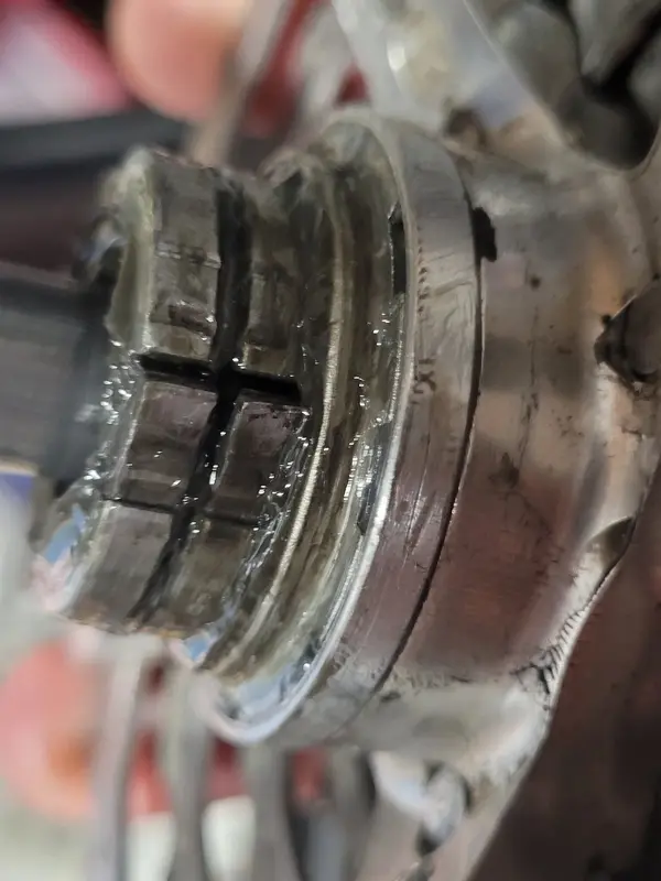

Any help on this?
I have the Hadley allen axle model. When i dismantled it,i kinda lost the shim order.
Now the freehub is grinding a bit on the hub flange (two yellow lines). Is there a spacer that goes there?
Also
-there's a rubber gasket/seal with a slot in it. It goes between the freehub and inside bearing. Does the slot goes inside or outside?
- There's also a small flat washer, not sure where it goes. Between freehub and inside bearing or Between axle ends and bearing?
Thanks for your help.
