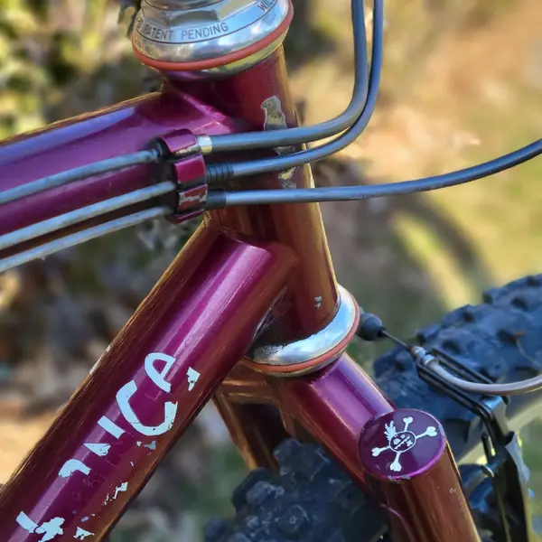

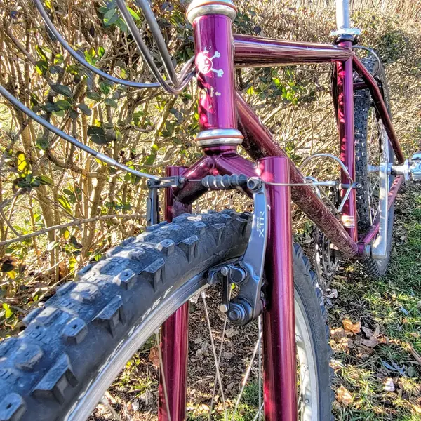

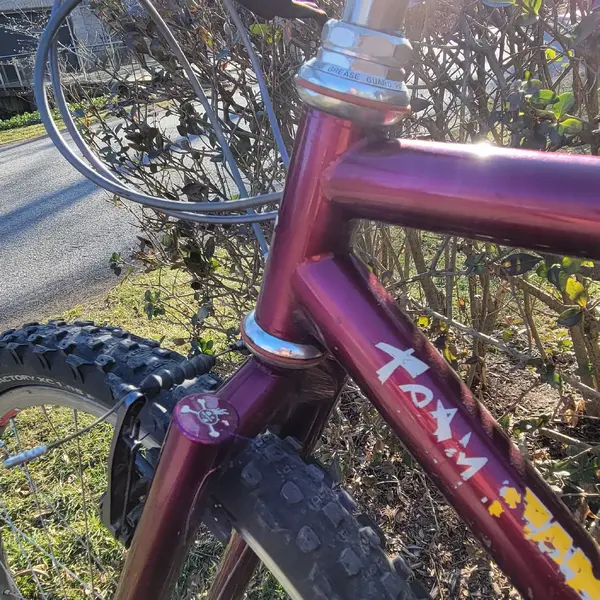

I saw that listing on E bay. Made me smile because it was the same as mine. Dr D's comments on the decals are so true. I would not touch the frame. Ride it, laugh with it, and just marvel what a great package the frame and fork are. When I got mine in 91 I scratched off the Chris Chance sticker on the chain stays, didn't like the look and still don't.
The bottom bracket is easy to change with a threaded rod, couple of nuts, wood blocks and a little patience. SRP has ti collars not sure if they are worth it, but interesting.

That´s a rare headset. wtb modified king.
As for the BB i would look for someone who has experience w/the fat city press fit BB and let him repack the bearings.
