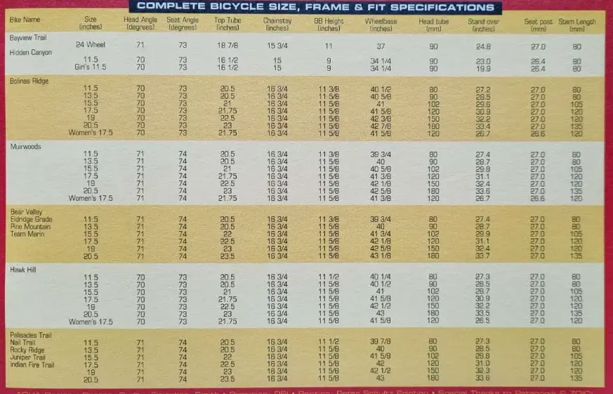

I joined this site because of this fantastic thread. I appreaciate the steel frame serial number tutelage, but I have one of my own up for peer review.
I have a vintage Marin Bolinas Ridge Ovation (4130 Chromo) with the following:
F019BSD097
The extra digits early on are confusing as there are typically only three.
F019 tells me (guessing):
F == Fairly
01 == "bolinas ridge ovation"
9 == 1999
BSD
The D sizing notes that center to center my bike should be 19". Measured center (BB) to center (TT) it is precisely 19"; the standover is 30.9" both putting the "catalogue" frame size at 17.5" (Medium). This makes sense as that year they offered three smaller sizes, two larger, and a ladies 17.5"
Peer review?
