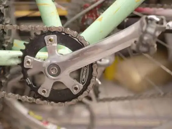

Also can i just use a 7s chain & normal crankset with the Granny and outer rings removed. It'd look a bit naff but would have do until i can get more cash..
It wouldn't look any more naff than this set-up I'm using (and I can live with how it looks..)
Just use a deep tooth chainring without any shifting ramps/pins and the same goes for the sprocket too. I can see no reason why a 7 or 8 speed chain won't be fine (as long as it's not old and knackered). Plenty of people (including me) use them..
32:16 isn't that "tame" a ratio - it all depends on the type of terrain you want to ride. I'm running 32:18 but some run 32:17 or 34:18 etc.
Different strokes for different folks..... 8)
