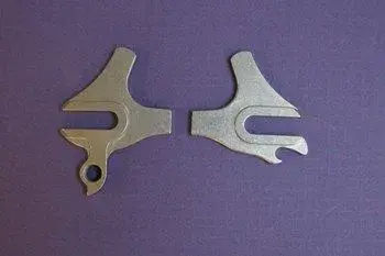

I like to use these drops from Paragon Machine works, as they have the horizontal slot but still allow for a derailleur if you desire.
