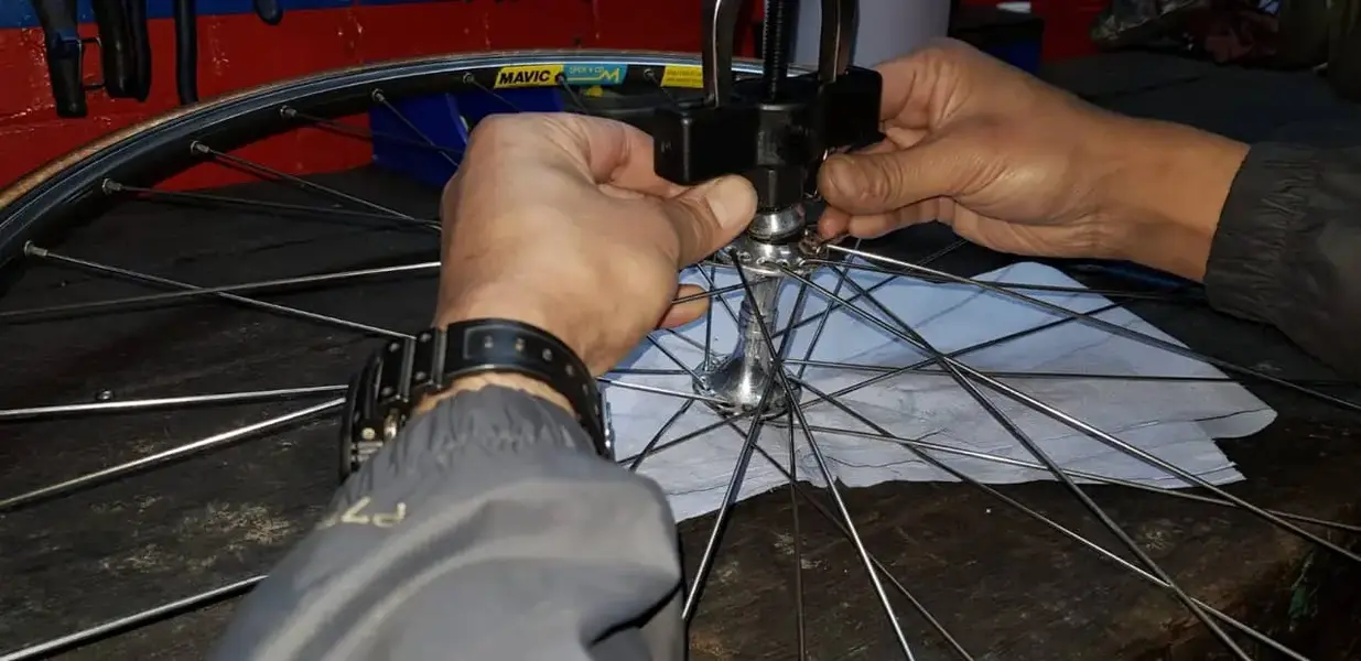

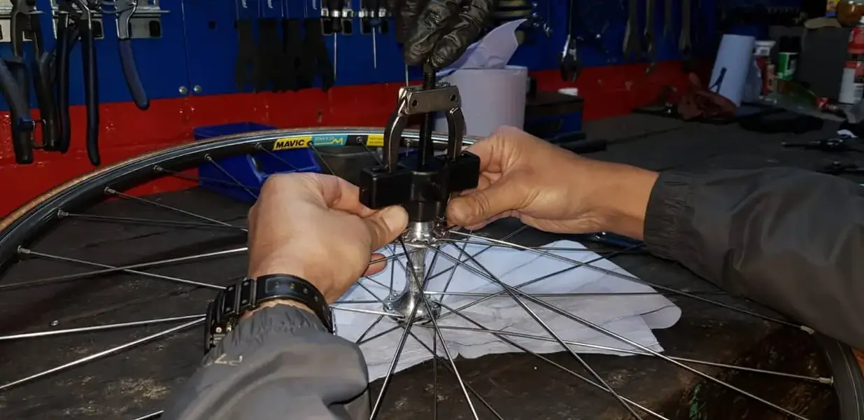

the wide screwdriver on a swiss army knife does the trick as it also has a bottle opener - it all fits in the gap and is of good quality stainless steel and doesnt mark anything
I found this on eBay, it works perfectly perfectly! Just use ‘cork’ under the central pin.
