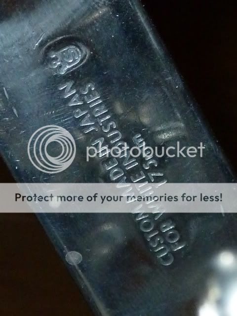

I still have the cranks I took off my 95 IFT that I bought new.
They have the "Made in Japan for White Industries" stamped on the backs, also they are not pocketed as I believe the real thing is, and are forged instead of machined.
Kind of what you've already been told I know, but I thought you might want to hear from someone with first hand knowledge.

There are Sugino made ones which are stamped wit the WI logo, then there are sugino made ones which have a transfer/paint type decal.
The real mccoys are stamped and (scalloped dished )pocketed type thing on the back and just look and feel different .they are shinier , lighter and have much crisper edges
I have owned all three, and currently own real WI and the sugino ones that did have the transfer before i polished em off
The crank i have now fitted is White Industries for a Marin ,they are engraved White Industries on the front but stamped sugino on the backs
