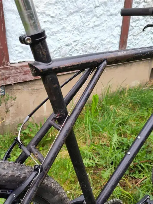

Thanks for all the work, this is a lot of super useful information. I have a frame number of a GT which I can't identify. The bb shows T9211 on the non-driveside and A018 1085 on the driveside. The frame has a 27.2 mm seatpost, the groove tube and the replaceable derailleur hanger that was used from 93 onwards. I guess the frame was made in November 92 and is an early 93 model? Is A018 the colour code? The frame has been oversprayed with black paint but I found red paint below. I am not sure if red was the original colour or if it has been resprayed several times. Unfortunately no decals and no other original parts are with the frame.

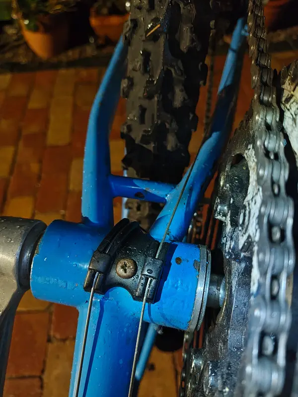

I don't think the red was the original colour - you'd be looking for blue and yellow:
The good news for you (assuming my records are correct) is that you have a 1993 Bravado LE. Seatpost size (if correct) also indicates this.
