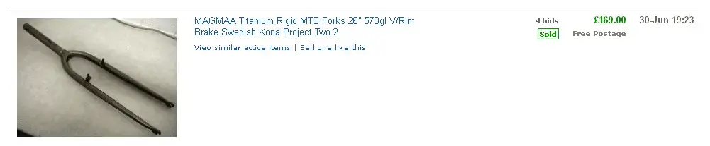

Magmaa Ti 26" canti fork at 570g actual. I sold these back in 2013, which I regret.
