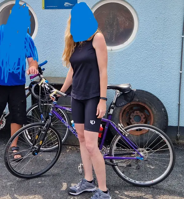

This is the unfortunately the best photo I have of my bike, it's a 97' Kona Kilauea. I'm heading to Europe later this year for a 9 day tour in Italy/Austria. It's the first big trip I've been on as have previously only done 4 days with no gear on my bike. I'm wondering if anyone has experience with pannier racks/bags on this or similar bike? The Ortleib bags have been recommended and I'm keen to buy something decent as would like to think I will be doing more touring in years to come.
At the moment I'm thinking a handlebar bag, rear rack & panniers. I won't be carrying any camping gear or sleeping bags etc so travelling reasonably light.
Has anyone got suggestions for a suitable rear rack and do you know if the 20L bags would fit without heel strike issues? Also any other suggestions to make the trip easier/more comfortable welcome :) Thanks 20230615_121010.webp
Ortlieb 20L bags are awesome, they last for ages. I’ve toured and commuted with mine for years. I use a Topeak rack, which is also been great and hard wearing. Yes, they may clip your heels!

I think maybe I recognise that bike from the CTC site? Are you going to put everything on the back? It might be an idea to include a bar bag to bring some weight forwards? Also useful for taking valuables with you when you stop. I’m planning to tour on my old mountain bike and have got a trailer to use which is another way of carrying the load. With the Kona having a small rear triangle, you want to check that your pedalling action isn’t compromised by your heels clipping any rear panniers. @hamster will have something useful to say.

Go to your local bike shop to get a good fit between the panniers and rack - ortliebs are very adjustable you won't catch your heel.
The rack might need extra spacer rods though as mtb frames are low at the back.

My wife toured with me for some years on a 1998 Fire Mountain - it was fine, the only problem with it (16" frame) was getting the left rack top stay not to foul the v-brake noodle.

Yes I did post on there a little while ago. I'm planning to get a bar bag as well, haven't quite figured out if it's best to go with a paper map or use my phone or what yet so that is another thing to consider before I buy those bits. We are doing the Alpe Adria so from what I have read and watched, it looks quite straightforward navigation wise. I actually have a toddler trailer that my boy has almost outgrown but am keeping it at least for this summer as me and my eldest were planning a couple day cycling/camping trip and I thought what a great way to just throw all the camping gear in! We won't be going far as she is only 7... Thanks for the suggestions :)
