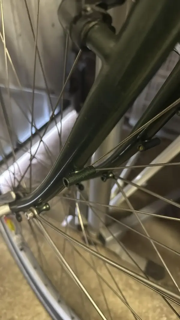

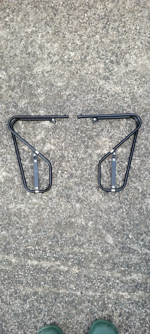

@bikeworkshop anything is possible of course, but it would be a bit of a lash up. The eyelets are designed for a braze-on BEHIND the fork leg, like this:
(whereas mine are central in the fork)

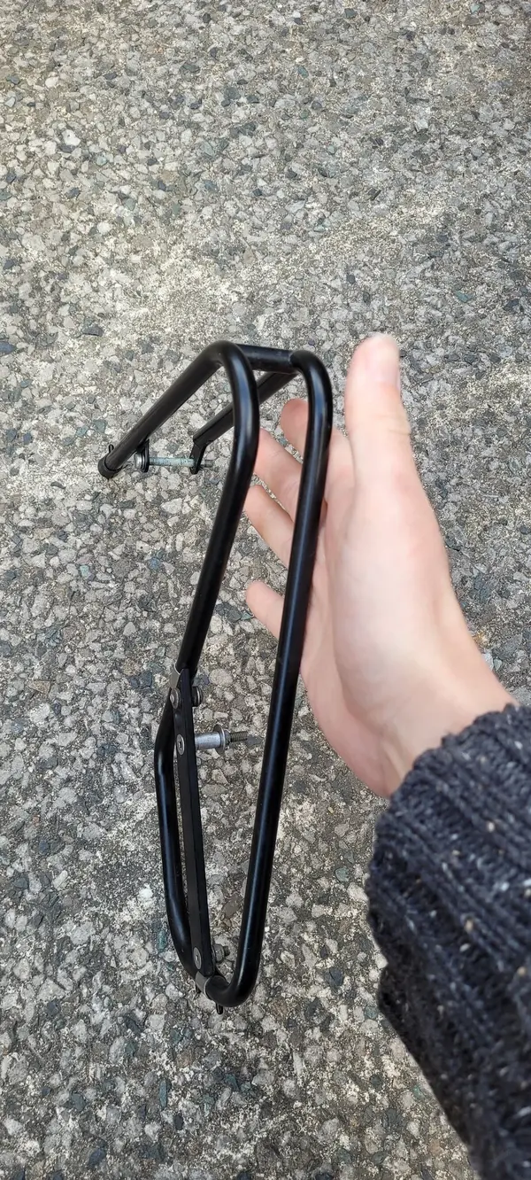

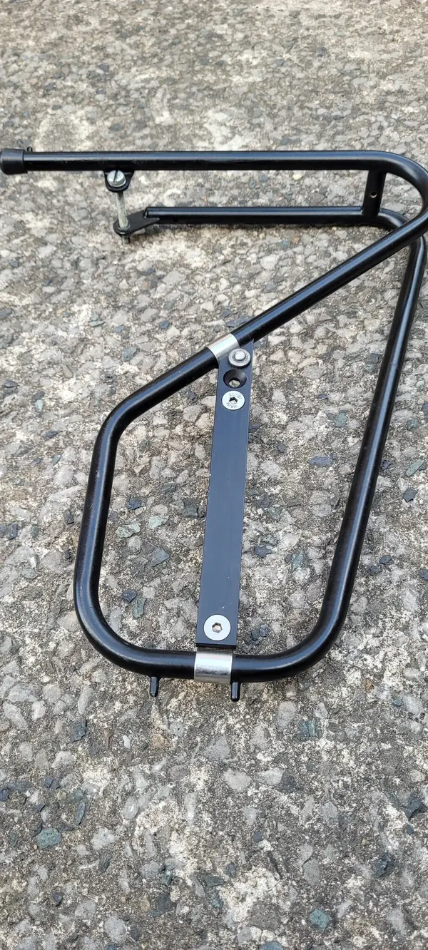

Think I am going to find either a hooped rack (a friend may have one apparently...) or single sided ones.
Here's some photos of those that don't work on mine, available if anyone is in need - they seem decent quality and have a vertical 'anti-sway' bar which I haven't seen on others.

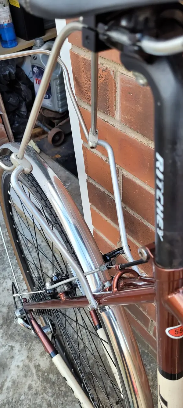

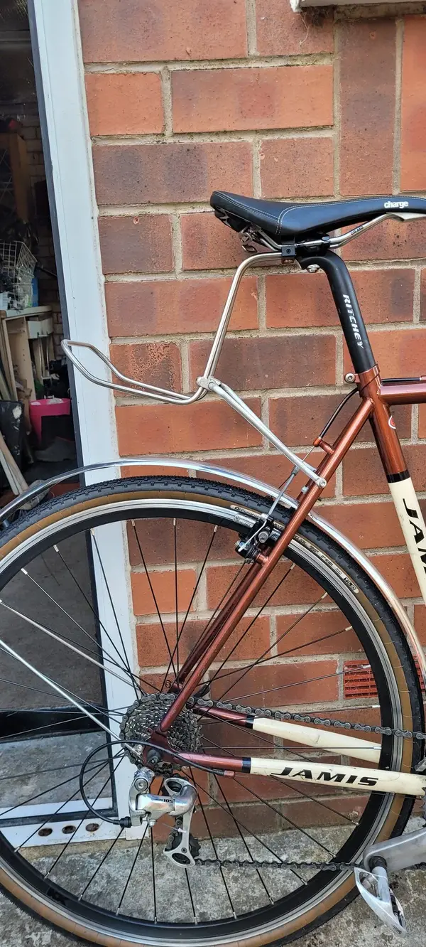

In other news I made some support bars for my Bagman support. Pretty rough but I enjoyed doing it using a very old pannier rack. Saved £20 or so too (Carradice sell them).

Those lowriders are very nice. Aren't they by Thorn? Should be worth a bit?
I can't find anything about these specifically, but they do look similar to other Thorn racks, so you may be right. I'll probably put them up for sale.
I thought you had the cheap aluminium ones (the fork topmount is often a slot) - those look like tubular steel and probably cost almost £100 new nowdays, like Tubus.
You could probably sell them and buy a nice fitting aluminium model with enough change to pay for a few extra cake stops on the journey😃
I like your Bagman retrofit, it looks very solid. I remember touring with a chrome Terry's support, which was forever rubbing on the back wheel!

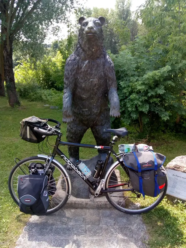

Surprisingly my Surly Long Haul Trucker in small with 26" wheels handles brilliantly with just small front lowrider panniers and a handlebar bag with just the small trunk bag on the back than what it ever does with an even load between front and rear panniers. Front feels secure and planted. Put the rears on when I need to but if I didn't need much, then the fronts are preferred.

The both-sides-of-the-fork lowrider does away with the over-the-top-loop, but you could make a loop from a length of 6mm(?) Alu bar and attach this to the rack with p-clips, as was often the case anyway.
If you look at the 2 designs, an inexpensive way forward should be possible.

@Jamiedyer that's very useful, thanks (on all of your points!)
Fitted a lowrider rack this evening - what a faff that was. Will need some final adjustments followed by a test ride, but the set up on the Surly (above) is similar to what I had in mind.
