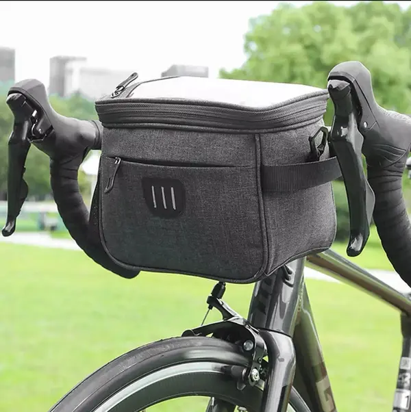

Intention is to run my bar bag, similar to the one you used as an example.
