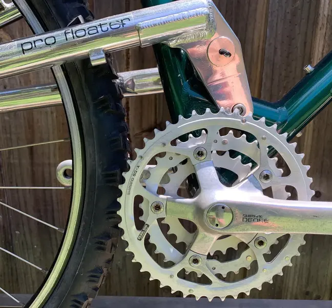

I've finally gotten around to my Profloater build & was surprised to find that I don't actually have a front derailleur (period-correct or otherwise) to fit it. I have over 100 FD's so this was definitely not expected. The seat tube takes a 34.9 FD & can accommodate either DP or TP versions.
Obviously, i'd really like to fit something period-correct but i've exhausted all of my current options. I.e.:
- Non series-specific band-clamp Shimano DP FD (31.8 but I made a 34.9 clamp for it)
- M900 34.9 DP
- Suntour XC Pro 34.9 DP
I've also tried to fit a range of more modern FDs (designed for 42t big ring, both low champ & high clamp) & none of them fit either!
Does anyone on here have a gen 1 Profloater with full-size rings (46t big ring) & if so, what FD are you running???
TIA for any assistance. :)

Tricky :?
The only thing that comes to mind are the e-type front mechs that are retained by the bottom bracket. You'd probably still have to adapt one a bit though.
SP
Thanks @ishaw but my frame is a first gen unit & there's greatly reduced space to fit a derailleur under the swingarm gusset. Most frustrating...

Splatter Paint":2dzqzc9f said:
Tricky :?
SP
E-bracket FD's came out quite a while after this frame was produced & use both a BB band & a frame boss to mount/locate. My frame has a press-in BB & no boss so an e-bracket isn't an option.
per this article the 1993 pro floater used an m900 front derailleur http://www.vintagemtbworkshop.com/1993- ... oater.html. There's a very good picture of the fd fitting. Not conversant with these derailleurs so i dont know what flavours of swing they came in. Just realised the picture is the same as previously posted. Accordingly i searched this site and came up with this http://www.retrobike.co.uk/gallery2/v/u ... 9.jpg.html - a 1992 pro floater. As they were introduced in 1992 i suggest you contact Mrkawasaki.
memberlist.php?mode=viewprofile&u=300
