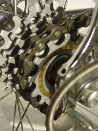

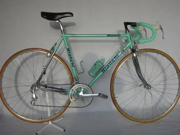

Hi Shaun,
Thanks for your help and link. Here's what we're dealing with
Mike
That's a short dropout, does it need an adjuster? I'd be tempted to file the inner part of that screw flat and screw the other side in to match.
Shaun
Might be a bit complicated but it could work...
Using a small tool like a dremel, drill a hole and tap it out with a reverse thread to what the broken adjuster has. Don't drill all the way through. Put a screw into the bolt and make sure it has the reverse thread to match. When you tighten this bolt it should loosen the broken one out.
It might be too fiddly due to the size of the job though...
Shaun
Yes I have never seen them on such short drop outs, it's on the Bianchi, sort of vertical-ish! :roll:
I was wondering about doing that myself, but didn't want to seem like a cowboy! :lol: :lol:
Mike
Ex-pro version here, came with adjuster slots, can't see a use for them on this frame.
File it off, relax & forget about it :wink:
