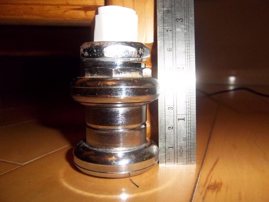

Just in from the garage and according to my measurements the stack height of the current Tange Levin seems to be 37mm. This seems to be higher than i was expecting as i had tried a Shimano 600 and it was too tall and velobase gives the height for the Shimano as 33.5mm. I must be measuring something wrong as SJS gives the Levin stack height as 33.3mm.

You've probably not allowed for the lip on the lock nut, that will take ~4 mm off the stack.

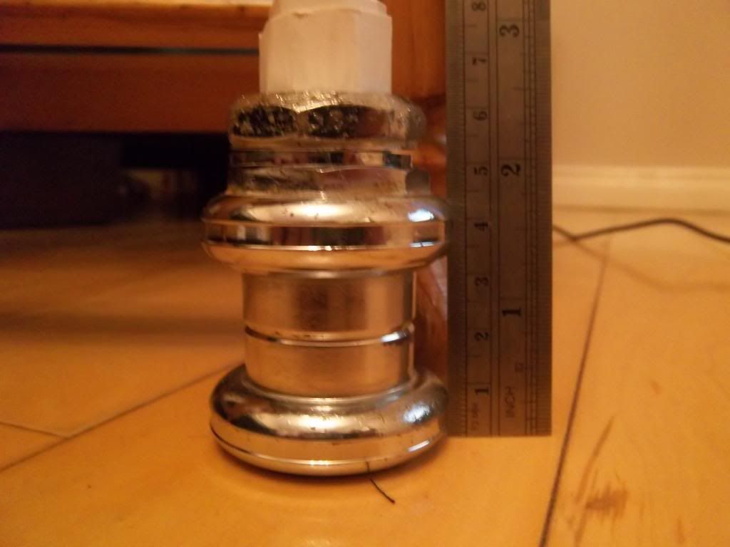

Pics of the headset with tube etc
So 600mm total, minus 2 x 100mm for the stems and minus 40mm (ish) for the locknut = 360mm. Where am i going wrong?

To me , that looks like a 40mm stack height in total so you need to find something similar to that . The 33mm one will fit but you will need a lot of spacers which look ugly . Your best bet is to cut the steerer down , or get someone else to , judging by your measuring :wink:
