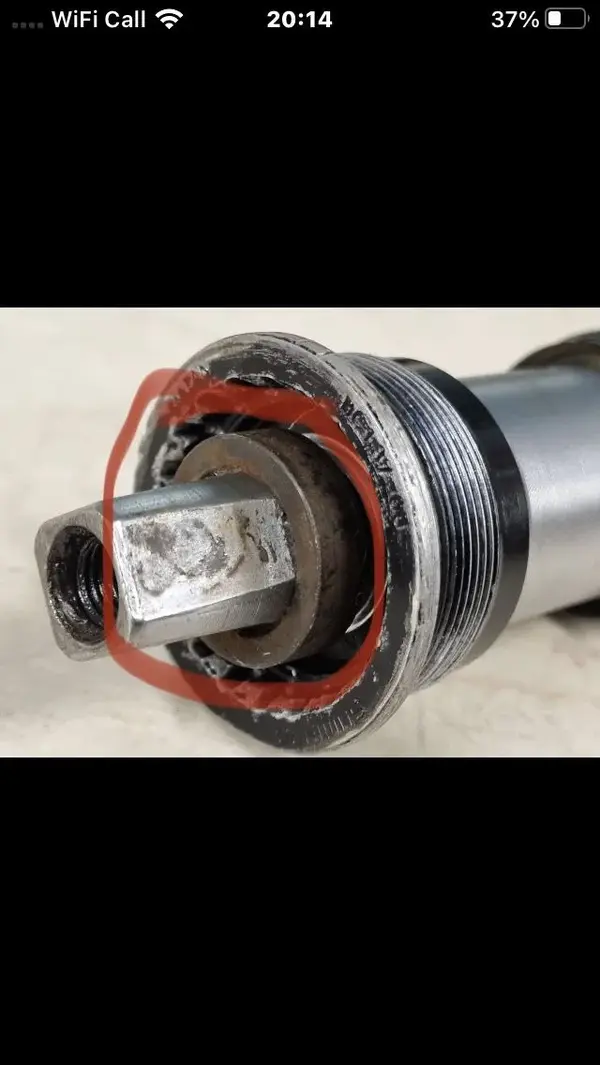

Has anyone removed the pressed in collar ring on the drive side axle of a Shimano square taper bb???
abr303
As above, has anyone have any advice on this…?? The reason I’m asking as it would give be options on bb choice if I could remove the collar due to an issue with a set of RS7’s…..
Got a pic @abr303? I'm not sure what you're referring to
The metal ring on the BB shaft? Yes done it manys a times...used a knife tapped in to get it started then flat bladed screwdriver, handy enough and replaceable if ye change your mind
Ditto. Done it many times.
I carefully drill in the washer (about 2 or 3mm) to relieve a bit of tension, then pop it off with a screwdriver. Just put a tissue or something at the bottom of the cup to stop the fillings falling.
