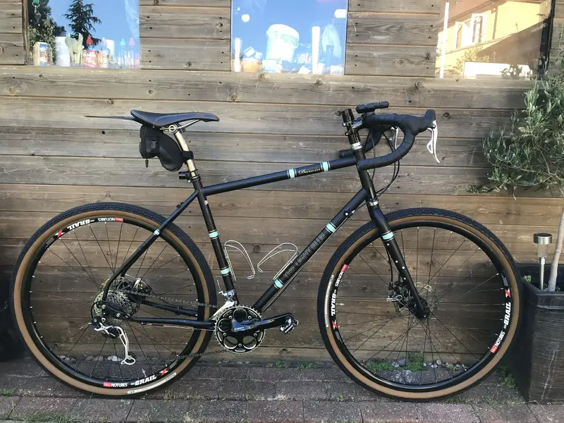

As for the gravel bike thing, I have a Light Blue Darwin frame (shop soiled) I have built up with 10 speed campag daytona shifters, a 9 speed xt mech onto an 8 speed cassette with Spyre mechanical disc brakes. I really like it a lot - comfort, handling, fun. I like drop bars and don’t get sore wrists like I do on flats. I use the drops for descending. The bars are level with the saddle and it took me a while to find a frame with short reach and high stack. I’m 6’1” on what is a medium but hta is slack enough I don’t get toe-overlap.
Just did the Dorset dirt dash on it fully loaded - handled it superbly. It done much cycling in the last couple of years. Sit bones hurt, legs knackered but I got back on it for the second day and I instantly thought this is super comfy. Just works for me.
Others were there on all sorts of bikes including 26ers. We all seemed happy.

Looks really good that. It’s always about the reach for me but that looks like it could work.
Yeah, I bought the stem based on measurements off my road bike so I'll be interested to see how much I screwed that up...
Don't forget to allow for BB height! A sniff more rise a little less reach....uhhh hmm ...been there!! it ends not being about what looks right but what feels right 😂 I suddenly had a flash of "ah f#@k it" inspiration and flipoed the drop bars over and hacked the ends off ! It's like a bar end position but in the curl!??
Looks erm well...🤔 But heck is it comfy 💪
