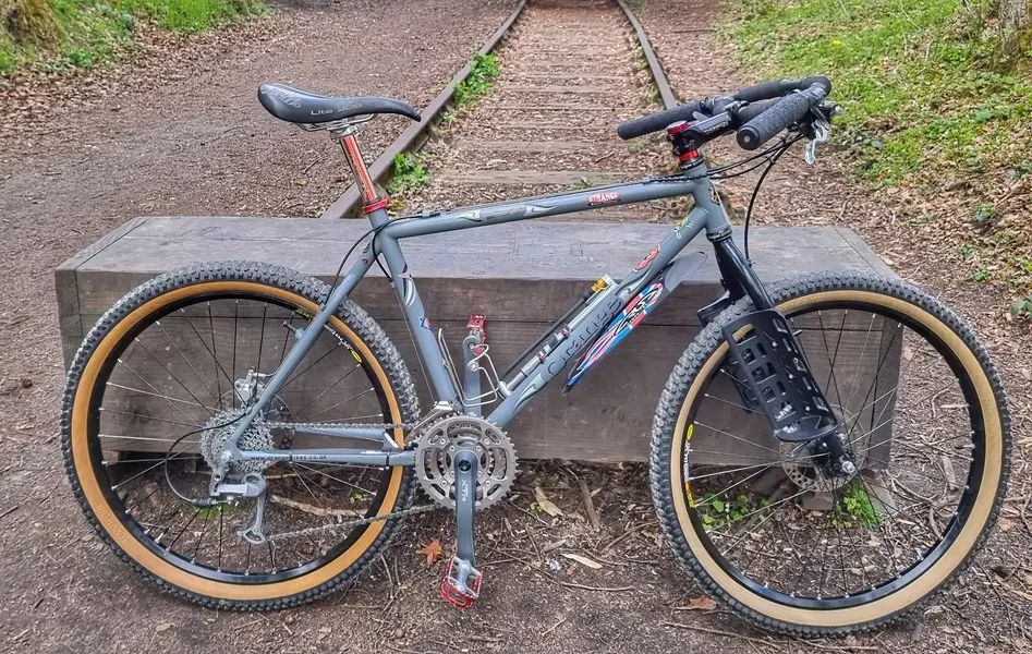

Rides lovely on road...a bit sketchy on gravel...a lot of effort and a fair bit of cash
Old dog 26" wheel retro MTB nailed together with a bit of road stuff goes like stink on road and off-road super comfy to boot!.doubt it's cost more than 50 Bob...
And yeah downtube shifters....cos it's all I had for 9 speed!
Bang for buck ol'dog wins 👍

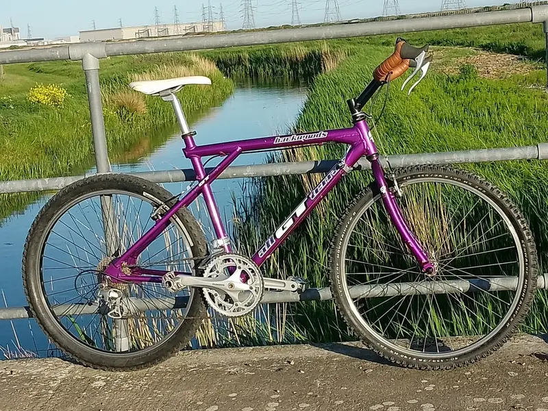

I've been using a Pinnacle Arkose X 650b gravel bike for commuting for last couple of months as my route is mostly offroad Done over 700 miles on it & find I rarely use the drops & even swapping the flared bars for regular drop bars not finding it as comfortable as flats. Finding my 2002 P7 with Jones Loop H bars & Surly Troll forks more comfortable & still nimble. Plus with it's higher BB can peddle around more bends without peddle strike. I may well end up flogging the Arkose.

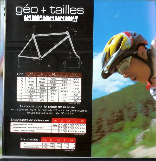

On-Ones tend to run big I think. That Inbred looks massive, according to this blog even in 2003 it had long and low geometry? https://muddymoles.org.uk/bikes/on-one-inbred-2003-geometry The 16" (smallest size?) definitely looks too big. For reference I ride pretty much the smallest road and CX frames I can find, and 650c for my race/TT bikes. I had an On-One Pompetamine for a while in the smallest size and sold it, as it was just too big ultimately.
