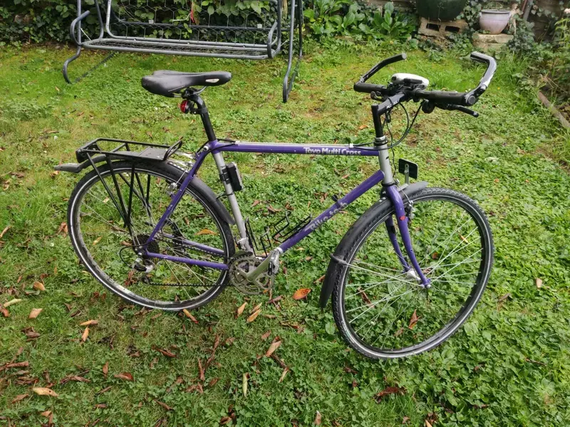

I also did it: '91 Bike-tech (Storck) Toyo (where the frames were built) Multi Cross. Actually I only bought it (out of boredom.) for the complete XT and some Ritchey parts it came with. But after taking some measurements it turned out to be an ideale candidate for a drop bars conversion and bad weather bike. The frame has clearence for 50 mm (!) 700c tires without fenders. What's also unusual for a hybrid of that time, is the MTB like bottom bracket height. It's just Tange Infinity and a bit on the heavy side, but super comfortable to ride. Really love it and I'm looking for second frame.

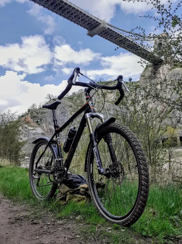

Used a Kona alloy frame (lana'i maybe?), with some random parts from the spares box. I ran V's with brifters and a bar end shifter for the front mech. Brakes were really spongy from memory, but they worked okay. Took it on a retrobike meet on the quantocks... Stopped for chips somewhere (anyone still here from that day?).

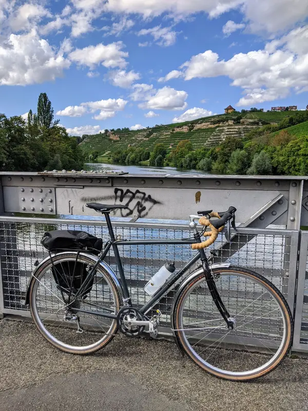

I built the gravel bike Dawes should have built in the 1980s as a successor to their WIndrush Rough Stuff oriented bike. They were still building lugged frames with 531db like this Cougar mtb.
I've set it up 1930-1950s Rough Stuff style with modern interpretation of Great north Road bars. It's got 60mm Super Motos slicks so it stays nippy on the road. I removed the vile 1980s stickers.
Single speed, of course, but because of my advancing age and growing enfeeblement, it may get a 3 speed S-A hub for long days in the mountains.
As a matter of interest 650b wheels with 50mm tyres fit, but it would need adapters for the cantis.

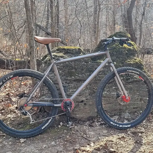

I fit 27.5's to this ti frame and put hydrolic disc brakes on it. I'm not a fan of drop bars but this made a good gravel bike.
I like that - and a Phil Wood rear hub with White Industries freewheel?
It's Sturmey-Archer rear hub and WI freewheel.
I've had a set of brand-new Phil Wood hubs on my shelves for a few years. I think they are over-rated and overweight compared to the much cheaper S-A hub, and so I've never got round to fitting them.
