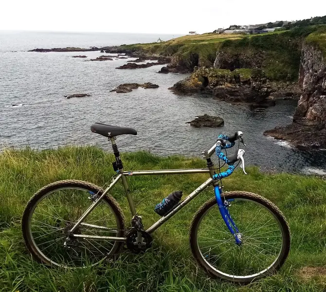

I'm currently experimenting with drops on my Giant, the stem looks a bit odd but it's comfy to ride and as above the RSX shifters work perfectly with the Exage in 3x7.
