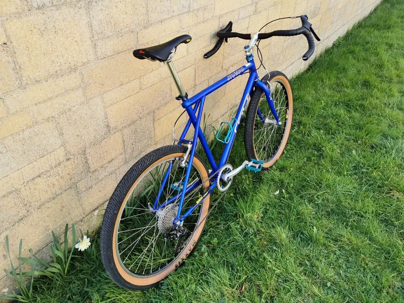

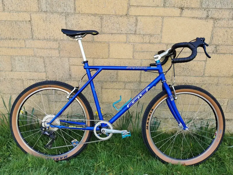

Has anyone built a Gravel bike using a retro frame

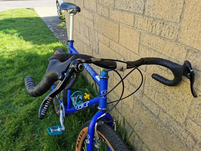

How do you like the shifter? I think they are a cool idea but have this feeling they mount a bit far away. But I guess downtubers are far away too and you get used to them :)
First ride today and they took about 2 minutes to get used to. Actually really easy and intuitive to use. 😊

I think gravel bars flare because it's more comfortable and gives better control. Mine are Redshift sports "kitchen sink". They're really comfy!
I stuck with 26" wheels, but only because I'm on v brakes, and so couldn't use 700c disc wheels, but if the frame was disc compatible, I'd probably have gone bigger.
I've got a modern gravel bike (GT Grade) with rigid forks and so have stuck with the rigid on the Bravado too. I didn't go off road today, but round my way the trails are literally gravel, so don't really need suspension. 👍

You just need to order the long pull version and then they do v brakes without any additional gizmos. Work really well, feels very crisp.
As you say, not cheap, but a nice bit of engineering and work well.
I think the long pull ones are based on the Tektro RL 520s, which are V specific. I have them (levers only) on a bike. They are quite comfortable but for big hand.
