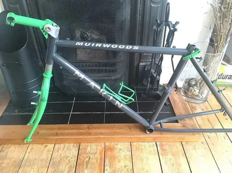

Hi Everyone,
Well, my '93 Muirwood is back from the spray shop & looking pretty slick in my opinion 8)
It terms of my rebuild, when refitting brakes, bottom brackets, stem etc - should i be using some locktite glue on the threads so things don't wiggle loose? Sorry if this is an obvious question!
And then with things like cranksets, BB and stuff - should i be adding any anti-seize "ingredients" into these kinds of things when i am re-assembling?
I really don't want things to start falling off once i am riding this beauty again :|
Feel free to give ANY advice, tips & tricks on rebuilds here... i'm really new to this process!
