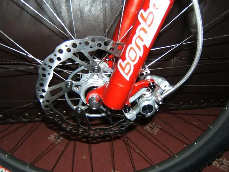

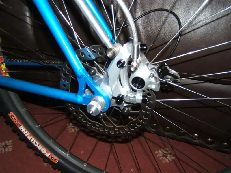

This is my set up using the lts disc mount[i think its actually a 2nd gen hope disc mount],the short axle on a hope bulb and a bomber for the front
The brakes are 2010 hope tech X2 so you cant get a lot more modern than that :lol:
These are post mount and as all calipers these days appear to be for 160mm ,fitting a post to IS +20mm for a front 185mm rotor isnt going to be much of a problem
I wouldnt recommend using the wavy rotors though.I found they squeal even in the dry.but each to their own
The rotors i use now are the proper round C2 ones,they're performing nicely and arent grabby at all.

I have one on my bike at the moment.It uses the same short 130mm hope axle in a ti glide or bulb rear hub[possibly big 'un too :? ]
It needs a special frame bolt as well thats the devil to find.and an xxl long rear skewer
All in all this system is hard to find,expensive when and if you do find one.It's other version uses a c2 caliper on an extra long mount,using the same frame bolt and short axle
That version is also expensive. [i just sold a complete system of the C2 version caliper and it sold for £165]
It is also a barsteward to get in good condition,I dont really think its worth the effort,unless it drops in your lap in perfect or fully serviced condition
I'd look towards the A2Z approach :?
