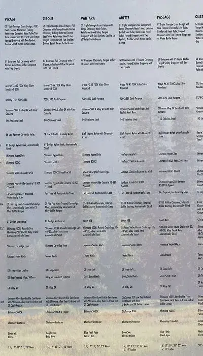

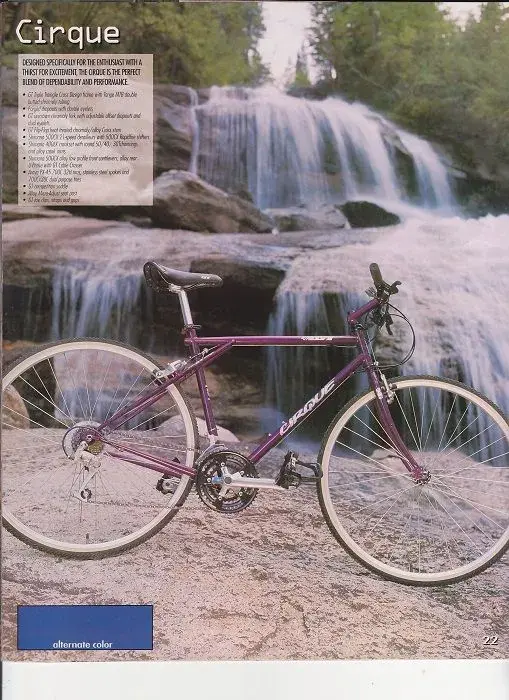

Sir, ummm...the GT Cirque was first introduced as a GT Hybrid/cross bike in the 1992 model year and it was never made with 700D wheels. Only 700C. The spec you quote is correct from the 1992 model year. 500CX with the 400LX crank set. In 1992 the Tachyon, Continuum and GT's first imported aluminum bike model the Virage all had 700D wheels but the other four cross bike models the Cirque, Vantara, Passage and Arette all had 700C wheels. So it's very questionable whether or not you could ever get the brake pads to line up on the rims. I'd say highly doubtful. Your tire choice width is probably limited to a 700x42 maybe 700x45 on that frame in order to clear the stays. see attachments
Wow, thanks for such a quick and detailed response!
The Cirque I saw is the exact same colour as your catalogue image. I had (wrongly) assumed that it might be a 700D bike purely on what little info Google threw back at me.
700c makes it a million times more appealing - straightforward CX tyres around the 700x35 mark should be fine, right?
