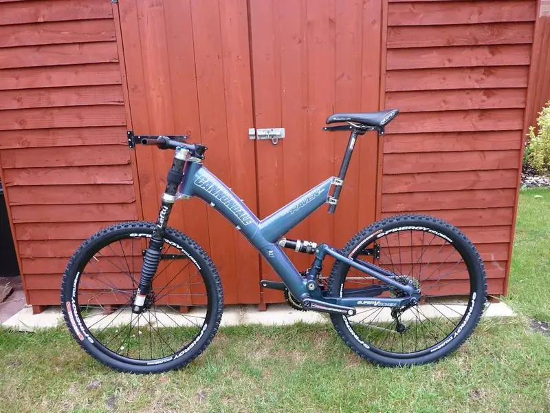

Thanks guys, the wheels turned up today and they are beautiful! Got charged no customs at all either. I have almost all the parts I need to assemble but I still have the problem of not knowing what colour anodizing to go with on her!
Going to strip the Risse shock off the other Raven, stick it on in basic form, slap the other bits on, take a pic and then I would love opinions for what colour ano to deck her out with. Got a gold sram cassette already but may well not go gold.

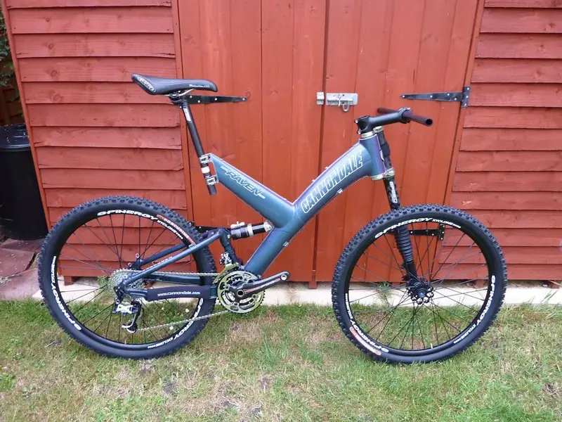

Right, there is a quick slap together. The wheels to look a tad subdued but not the end of the world. Guys, any opinions on what colour to go with the anodized bits?
Cheers,
Nick :)

almost dead on 26lbs fully assembled as I didn't go supert lightweight with everything. I am too old to be fixing punctures all the time etc so things like heavy self sealing inner tubes have been slapped on.
Once I get the hoses cut down on the brakes I am going to post her up along with the spec. Will prob post up the other raven too and too D-Jab as she has been totally overhauled as well :)
