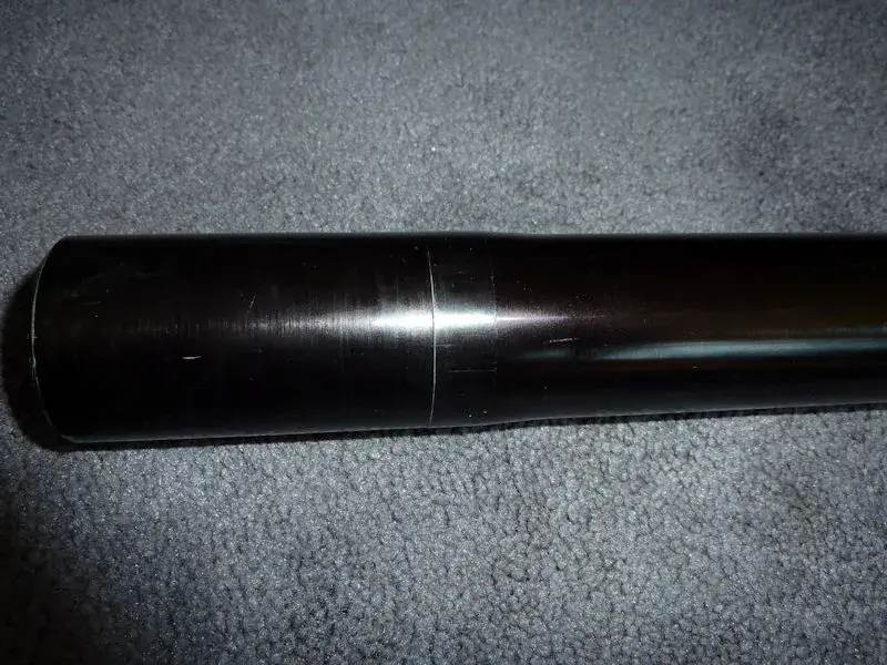

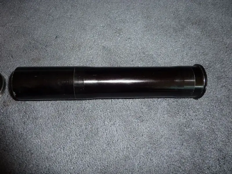

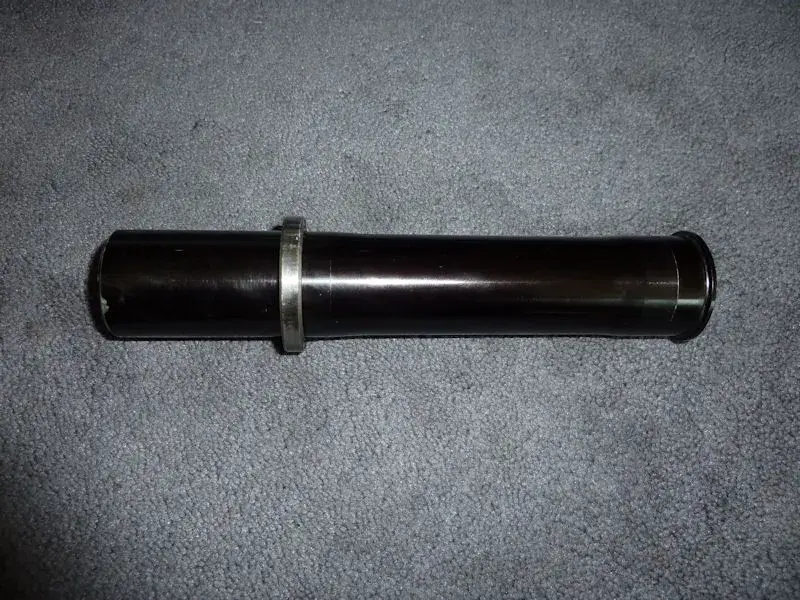

Basically I got my lovely Lefty Carbon 110SL fork for her and it came with the steerer tube. I bought brand new headshock headtube bearings, popped them in place then proceeded to fit the fork. Slight problem, I can't get the steerer tube even halfway in! It stick as it tried to pass through the first headtube bearing. The steerer is slightly tapered, with an additional slight increase in size just where it it tries to pass throguh the bearing. I have taken pics that should appear at the bottom giving you an idea of what I am on about.
Cannondale manuals are fairly non-existent at best but in a supplement manual I saw references to a plastic mallet being used. Before I go with the brute force and ignorance approach, who else has had experience with this? I don't want to knacker the bearings by smacking the steerer tube through unless everyone else does it this way and the bearings will be fine?

yup, thats basically how they work, the bearings are an interference fit on the steerer.
mallet for the win
Ok thanks for that. Just to confirm, smacking the steerer through past the bearings isn't going to damage them and you guys have experience with doing this? ;)
Thanks :)
Thanks :)
Just check you have the right size bearings and yes that's how I've done it on removal and seen it done on fitting at the shop I worked at.
Ok, hmm there are different size bearings? These press in to the headtube perfectly at both the top and bottom. I ordered them off Ebay at the same time that I ordered the fork after looking around and seeing what appeared to be all Headshock bearings being the same size?

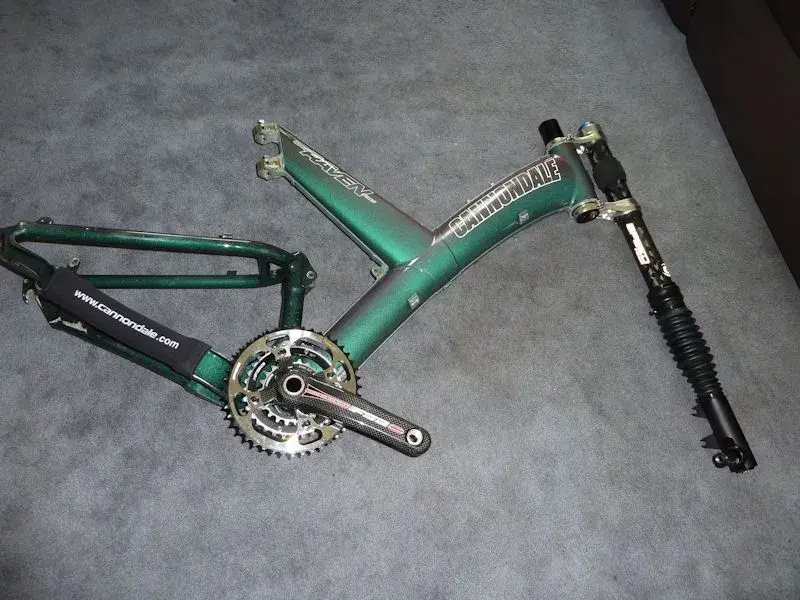

Well, big rubber mallet turned up today so after a liberal application of teflon lube, I set about smacking it in to place. Took a little while and made me grimace a bit but all done. Thanks chaps :). Now I just have to figure out exactly what sheels I am going for and what colour anodized bolts to put on her and I am pretty well ready to build!
