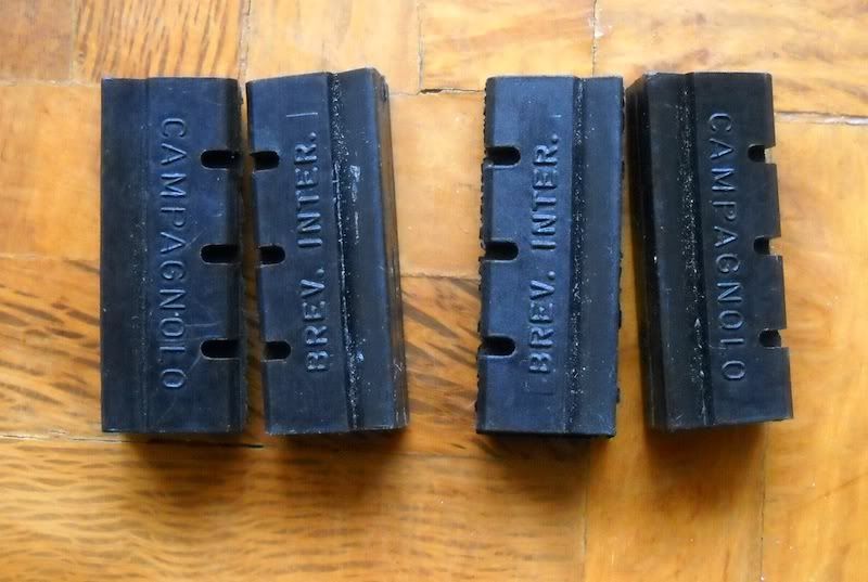

Brake pads NOS x4

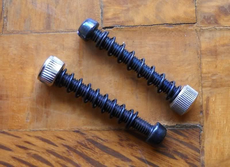

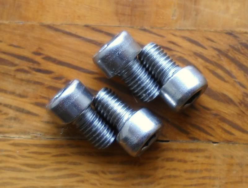

Cage bolts x4

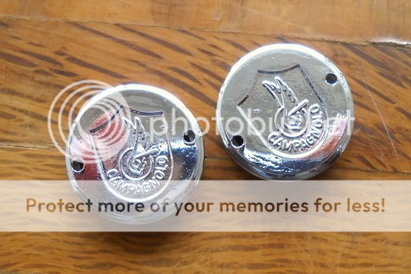

Dust caps NOS x2

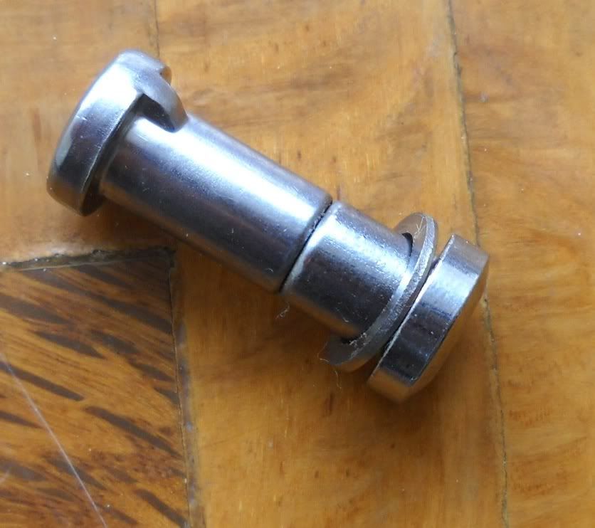

Before I left this morning another parcel arrived with a very small and yet such a crucial part. The "Conical Nylon Washer" is here! 8)

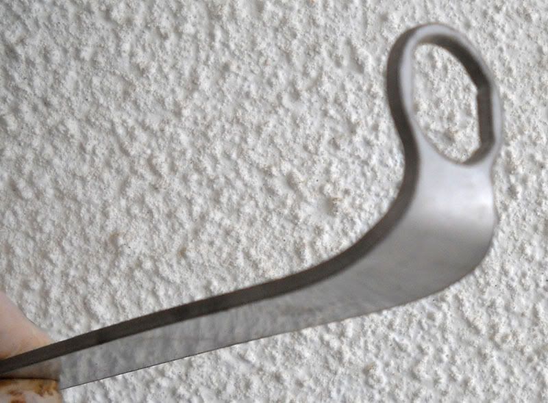

A friend from another forum made me a "indecent" proposal and I said yes! :lol:

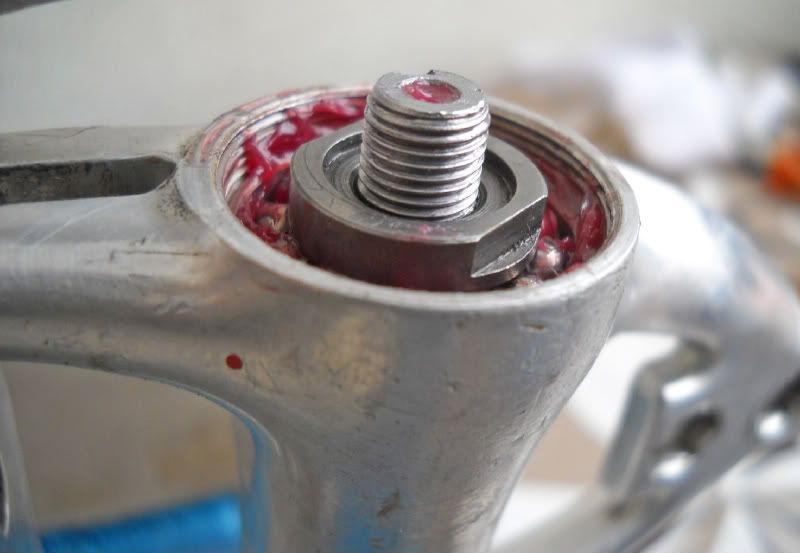

I needed a couple of tools for the bottom bracket cups and one to adjust and hold the pedal cones. I've sent him a sketch of the tools with all the measurements early this week and today I got the tools in the mail.
They are still raw:
I need to get a file to clean those edges. The "big" tool works great. I've open the BB lock-ring with it already! the "small" key still needs to be bent twice and in fact I can't get the cone to fit. I believe after the file work it will fit nicely.

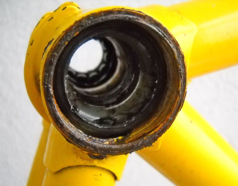

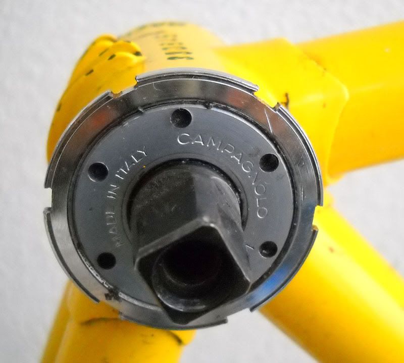

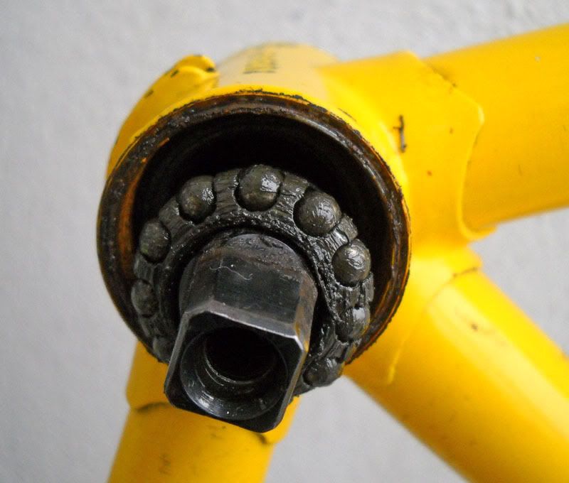

This morning and using the new tools was time to take the BB apart.
Here's a non drive side view.
The tool fited snugly, did a little push and the lockring came loose. Removed the cup.

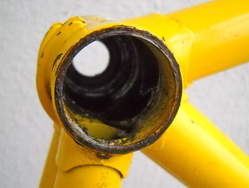

Removed the spindle and bearings but the plastic sleeve was stuck...
It came out in the end along with the right side bearings.
The plastic sleeve is a bit bent but I think it's going to work anyway...
to the cleaners!!! :lol:

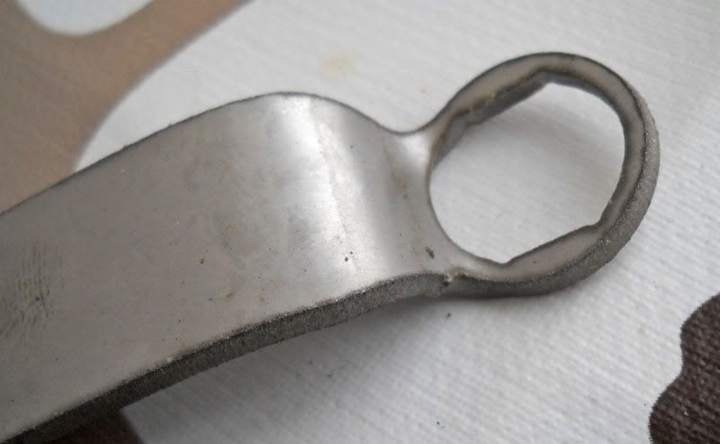

Did the cone tool this morning also. Here it is. It needs to be bent twice and some file work as it doesn't fit the cone yet.
1st bend.
2nd bend.
That one was close... it's difficult to do that without a proper vice. After 30 min of file work it was ready.

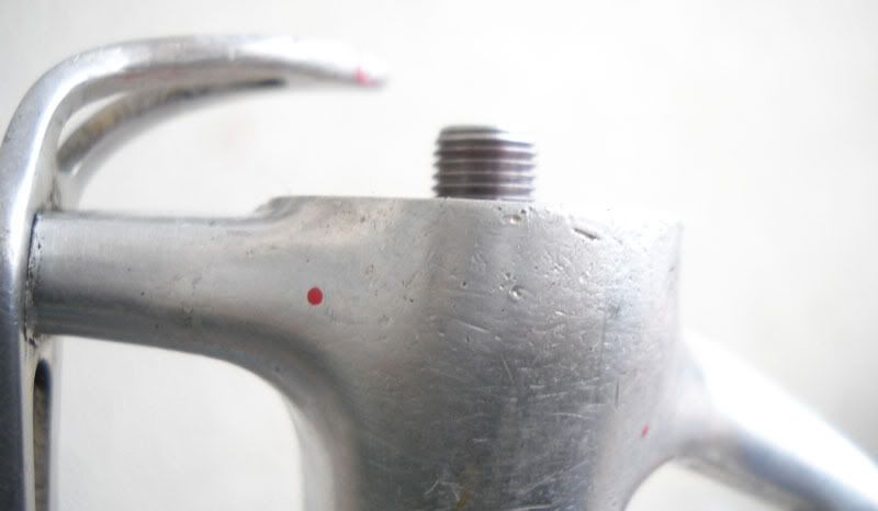

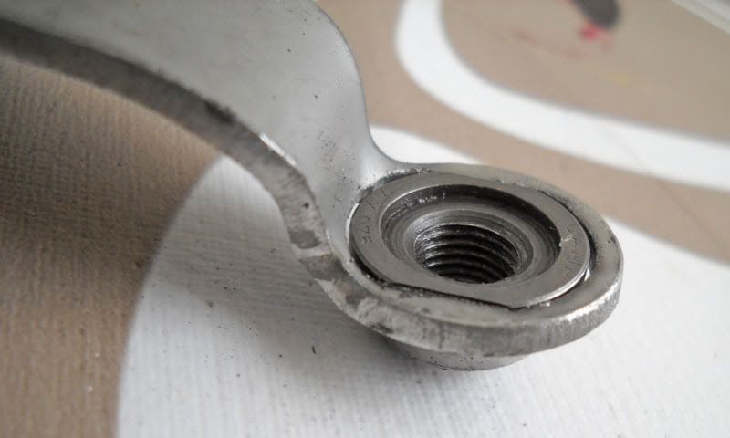

Here's the pedal with the cone already in place. It still needs the locknut to hold it in position. With a regular set of cone wrenches you can't hold the cone and tighten the locknut. The cone is completely hidden inside the pedal body.
with that little tool it all becomes easy!
