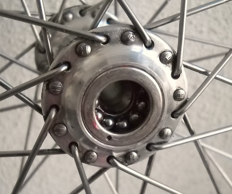

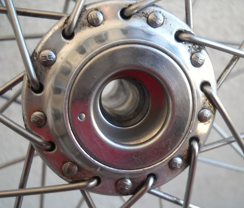

Finally had a morning off so I decided to open the rear hub. If you guys still remember it was the one making a strange noise when spinning.
Here it is:

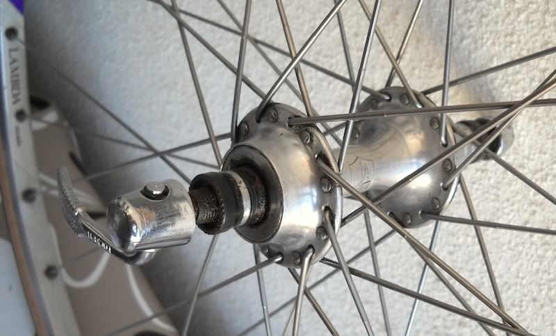

Remove the skewer. "Grab" the cone and undo the locknut.

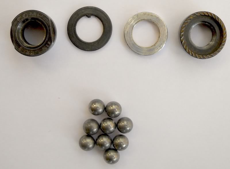

Remove the locknut, then the washers and finally the cone.

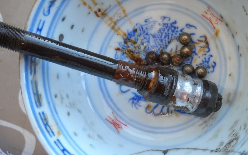

Back off the axle just a little and remove all the bearings from one side. Turn the wheel around, remove the axle completely and them remove the bearings from the other side.
What a mess!
Now to clean everything. The races access is not the easiest one but with some patience it can be done.
The cones don't seem to be in a bad state. The bearings could probably still work but as I have some new shiny ones these are going to be replaced.

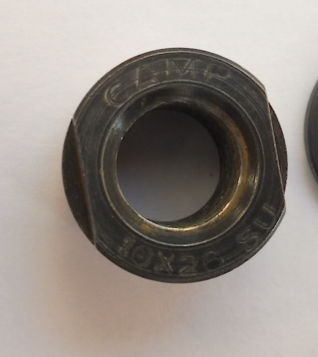

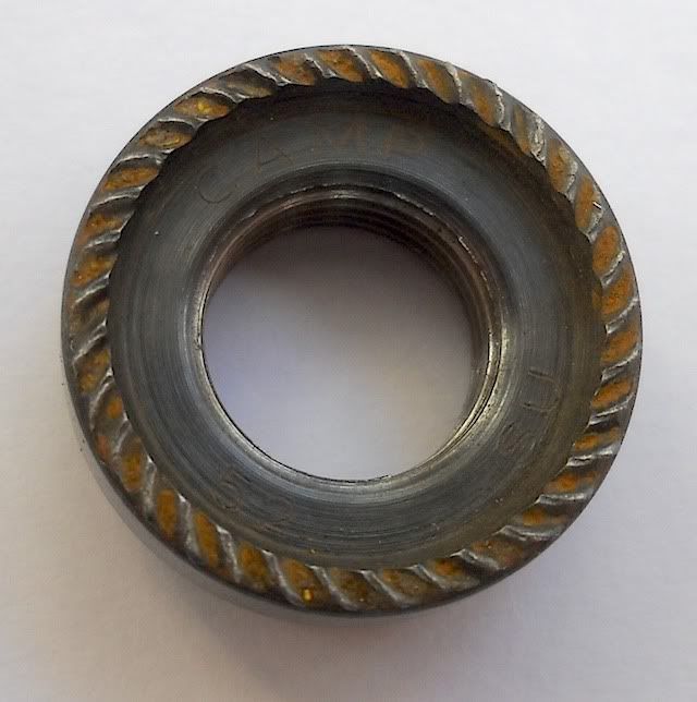

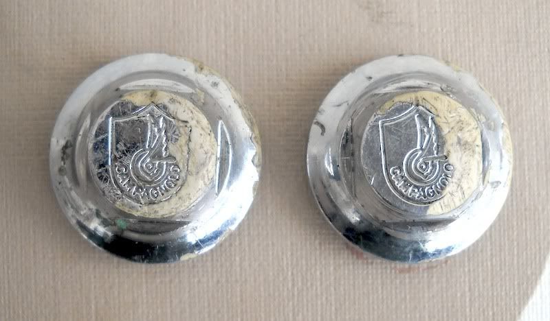

They engraved Campagnolo everywhere. The axle is engraved as is the cone and locknut!

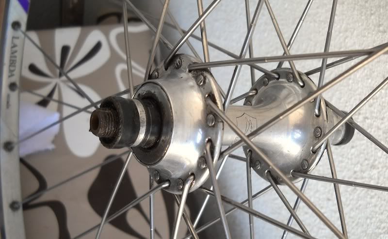

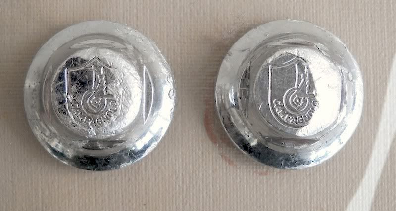

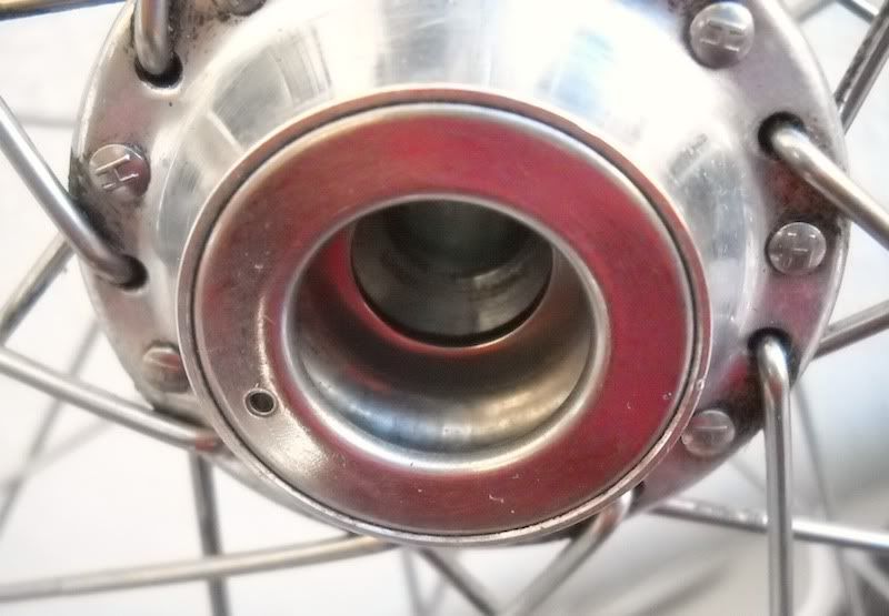

Did the front hub today. No strange sounds coming off this one but decided to do it anyway. Removed the dust caps this time as it makes the job so much easier.
Here's the front hub already open and cleaned.
These bearings glow like new. There are going back in.
Put some new grease. Put the dust cap in place and then the bearings.
Insert the axle and repeat the same operation on the other side. Thread the cone and tight that locknut and it's ready!

Top servicing job
Yes, removing the cap makes it much easier
I was afraid to damage those dust caps while removing or on reattachment.
Today I wrapped a rag around a screwdriver and they come off easily. It's easy to put'em back on also.
Makes the whole cleaning and re-greasing process so much easier. 8)

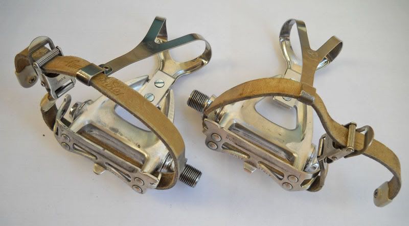

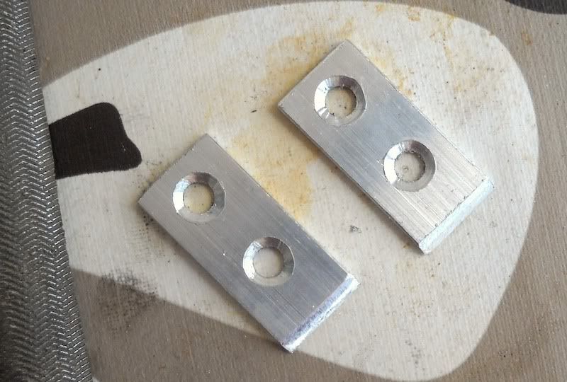

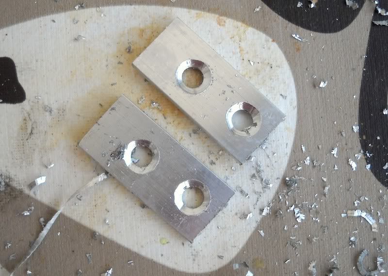

If you still remember I was missing a clip fixing plate to one of the pedals. Here's the original one.

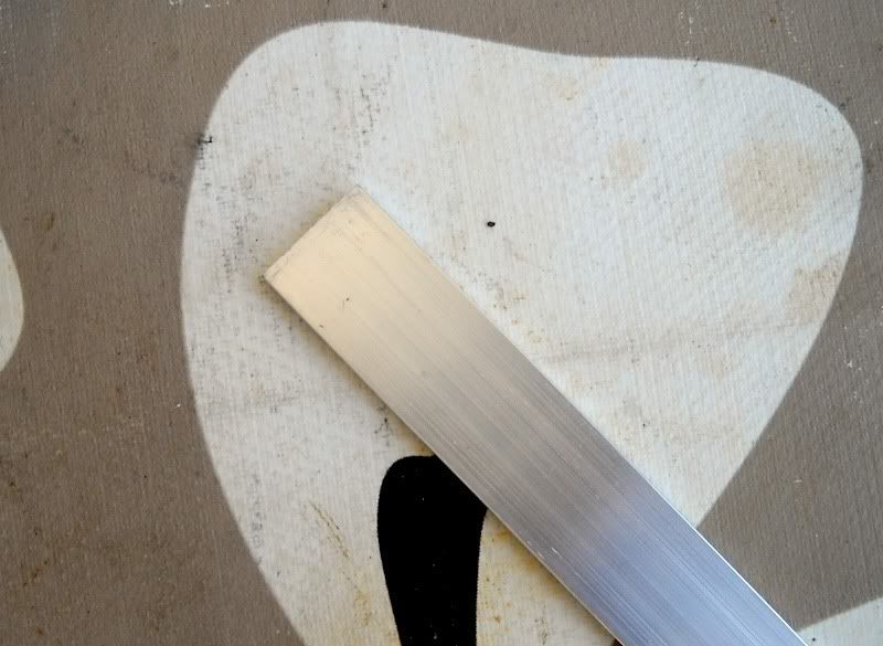

Bought a piece of aluminum and decided to do a new one.
Cut it to the right size but decided to make two so that the pedals will have the same look.
Drill the holes and do the countersink.
Do the front and remove any sharp edges.
Give it a good rub with steel wool. It's going to take some new bolts and nuts.
Done and done! 8)
