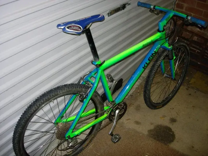

Anyway some poor photos of my 93 taken a while back. I can take lots more if you haven't already got lots.

Cant decide whether its two colours which when they met produce the third colour or whether its sprayed in three colours?
The other option is to go for one colour which will probaly be fluoro...got to be wacky if its a klein!
It looks like 3 different spray colours rather than two mixing to me, but is difficult to pick out in most photos.
andrewl":a4q0huny said:
http://www.kleinjapan.com/tech_guide/pr ... manual.pdf
on page 34 and 35 the colors are listed. Klein used a base layer (white) and then 3 colors for 1 or 2 coat layers to create the fades. i.e. the "yellow" and "balloon blue" are single colors over the white base and the green results from "powder blue" sprayed over "yellow" over the white base. and all that wet on wet iirc...
