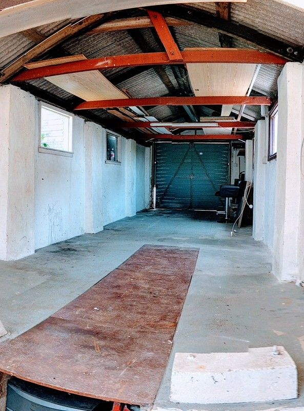

Hi all, as spring/summer approaches, I want to get my head straight on how to tackle my goal of insulating my garage/general improvements to make it a more habitable place in the colder months.
Below is an image of how it looked before we moved in:
My main issue is the roof. Is just corrugated sheets (probably with asbestos in) which I don't think need replacing. There aren't any leaks that I'm aware of.

Used sheets of polystyrene 50mm think to insulate my work shop (it was free) ;) but used 25mm celertex for the wife's work room/summer house with fairly similar insulation resultse the sellertex is easy just cut to size with a saw or big shape knife and wedge between the roof rafters :) will cost a few quid for a roof that size though! as for the Windows they should pop out easy enough as there should not be much weight from the beam above, should all be easy enough but be very very careful not to disturb any of those roof sheets!!!

Do I need to worry about condensation? Leaving a gap between the roof panels and insulation panels to allow condensation to evaporate?? Will I need some support across the insulating panels as the gap between the rafters is quite large...
Looks a well built garage. I would prep insulation panels and run them flat across, leaving an accessible void for storage. Put a number of vents in the panels. The floor looks really good too, I would imagine it has a DPM already in place. Condensation is always an issue in 'unheated spaces'. If you are planning to use the space as a workshop a decent size wood burner would render that a toasty warm environment. You may not want to go back into your house!
I would personally leave as much natural light coming in as possible. If security is the issue then other things can be done.
In fact, if it were my building I would be removing the roof at some point and glazing it entirely!
Is there any ventilation where the roof meets the walls, Martin? What's the gap between the timbers?
We sell 8'x4' osb boards with Cellotex attached, 99mm or 120. As hf says, you can still have some storage above the workshop, and won't be wasting heat in the top of the garage.

I was thinking that, I'll have a good measure up. There is a lower section where you see the inspection pit, there are steps to a small worktop area near the back end of the garage that has a sloping roof (not the same type of roof as the rest of the garage). Will get more pics of that tomorrow hopefully.

Honestly, for the trouble, I'd seriously look at removing the roof panels, and installing a better roof 'system'. Either pre-insulated metal panels, or as HF said, maybe poycarbonate sheet; you can never have enough light in a workshop.
You can remove the roof yourself, bag it up, and get it disposed of by the local council facility for next to nothing; permits, licences etc only apply if you're a company.
