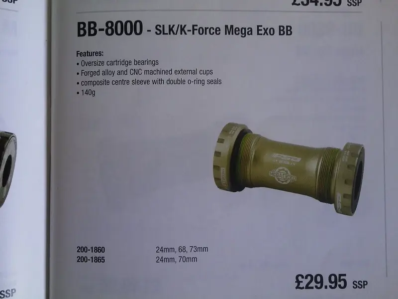

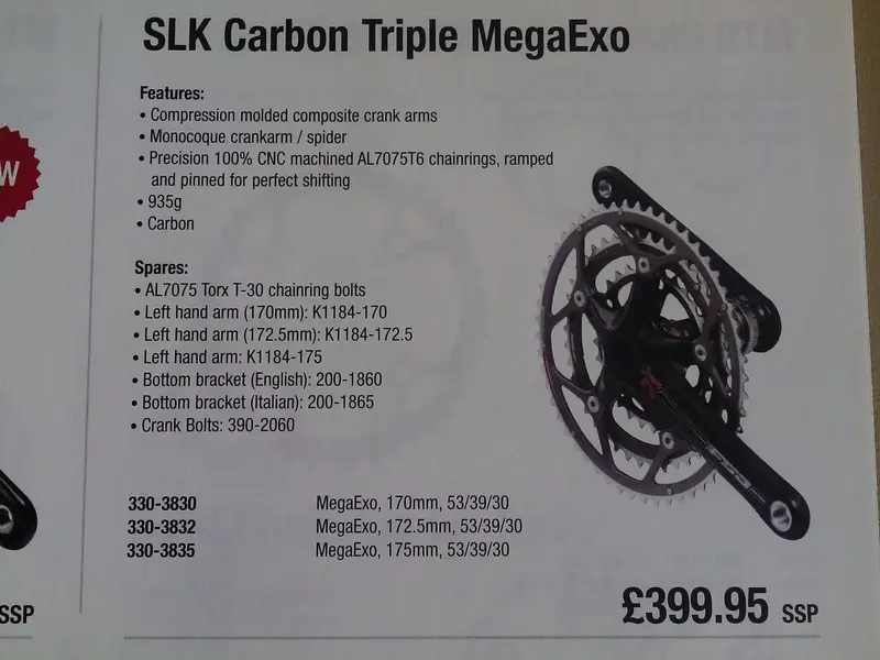

Bit late to the party here but wondered if these photos might be of some use. Taken from the 2008 Windwave catalogue (FSA distributor), and shows the SLK Carbon Triple MegaExo chainset and the corresponding bottom bracket as the BB-8000. I'm guessing this is the triple chainset you have?

Thanks rikster - much appreciated.
Yes, those are the exact cranks and that is the recommended BB.
It seems there are other options though - so some trial and error might be in order.
The 8000's (new) are about £45 now - given price hikes recently, i suppose that's not too bad.....
Except it is if you find the colour repulsive.
