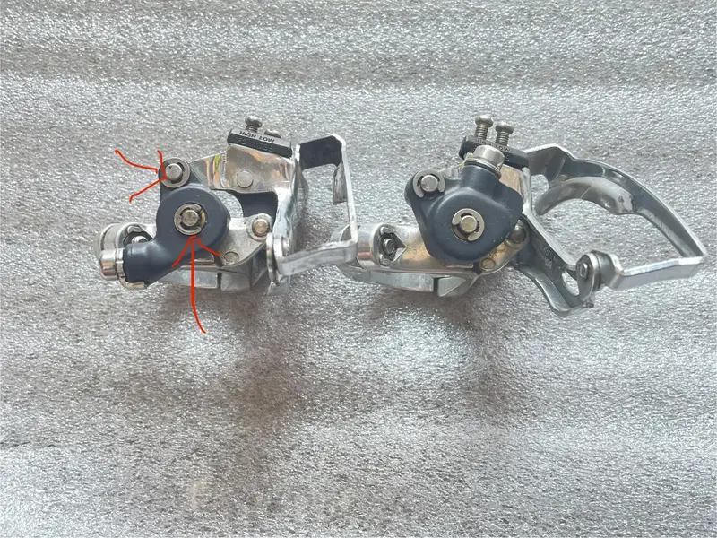

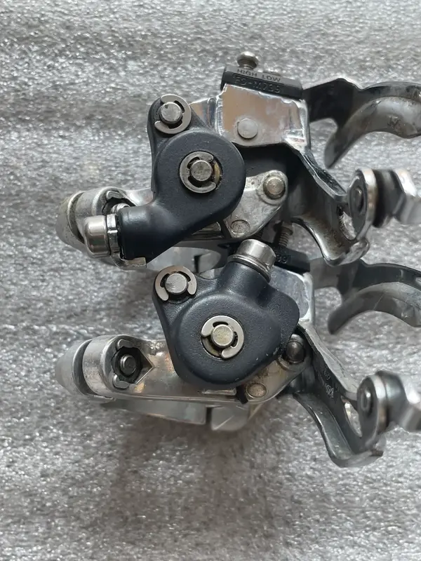

Below are two Deore XT M739 mechs, one is 31.8, one is 34.9. One top pull, one bottom.
The mechanism is the same, only that grey part differs. Remove the clips arrowed and swap the parts. Obviously there are springs inside so take care not to lose one, or hurt yourself. It's fiddly at first but easy when you know how.
