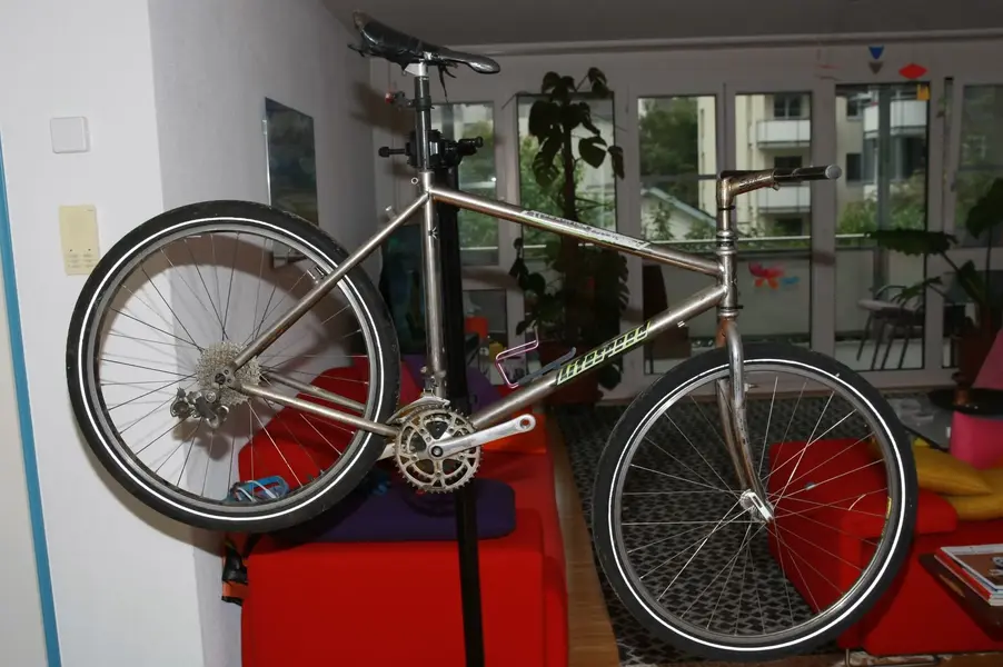

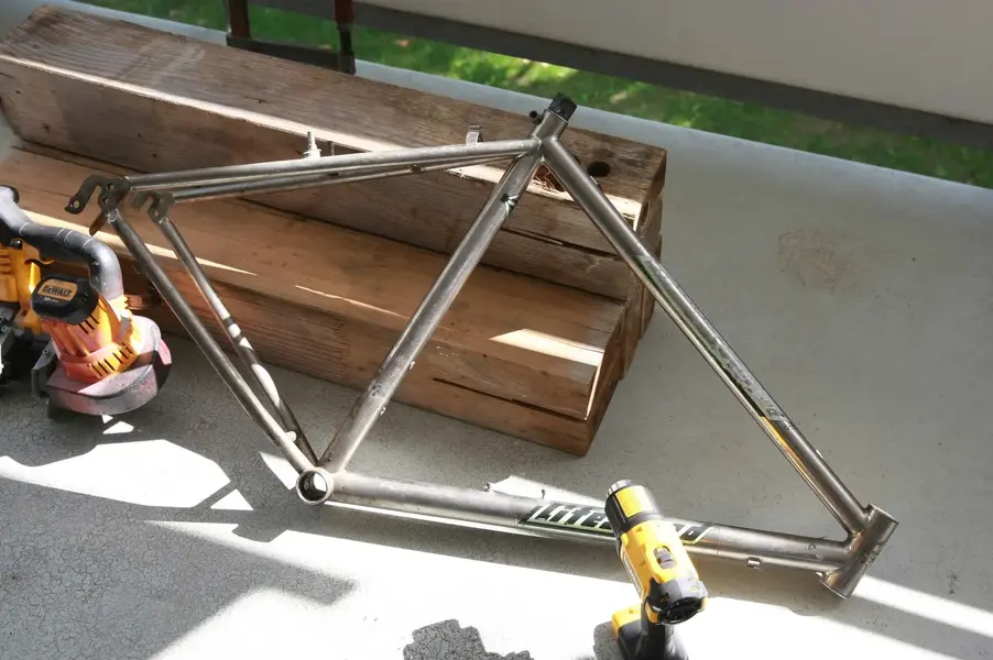

What I think I have here is a 1991 Litespeed Mountain. I digress, I don't know much about these frames or brand, but am looking forward to the slow burner of a build. First, any insight on what I am dealing with here?

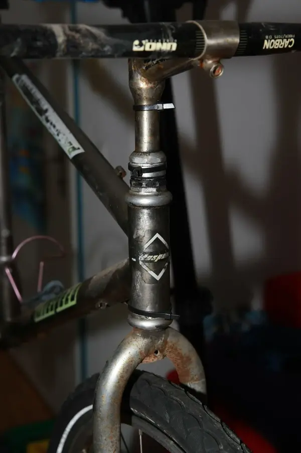

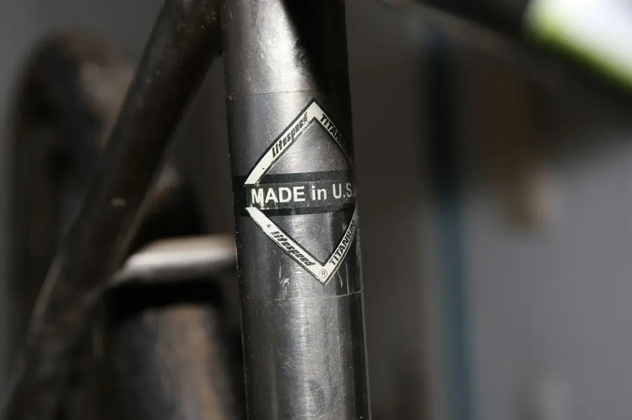

- Head tube badge is the diamond sticker
- "Litespeed TINANIUM" stickers on the top tube rule out 1990

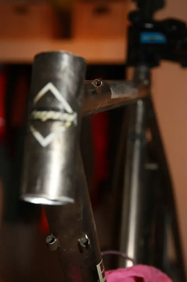

- cable routing @yakboy is two along the bottom tube, one along non-drive side top tube (see pictures)

With all things considered, I **think this is a 1991. Size 19"/48.5cm with a 100 mm head tube. This frame has the "oversized" downtube option.

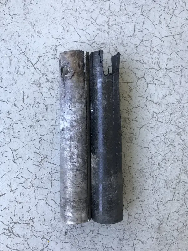

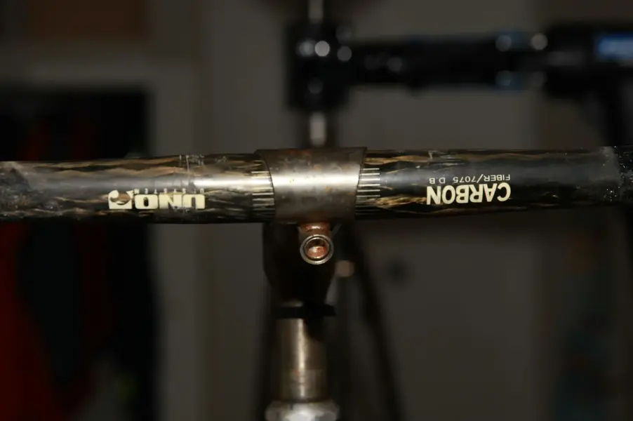

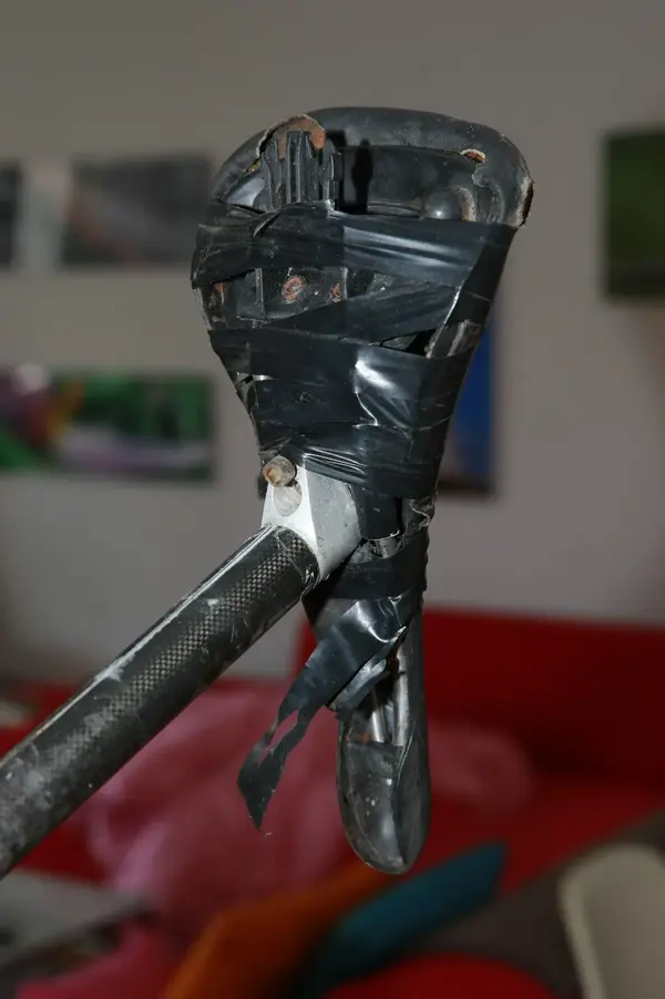

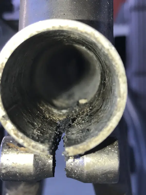

2) Seat post! Ahhhhhh! In the prior thread where I asked for a value, the seat post was brought up as being suspect. Upon inspecting the bike in person the seat post was stuck solid. I mean, rock solid. See pictures below for extraction. Also! Carbon wrapped aluminum seatposts!? What were you thinking!?

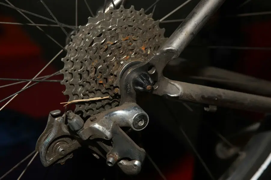

3) Rear derailleur hanger is a tad off and the rear dropouts are a tad off, but I have the tools to correct that.

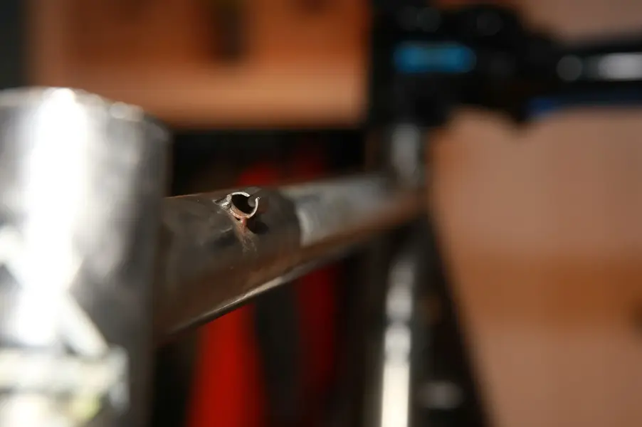

4) The cable stop on the top tube nearest the head tube is slightly crushed. Not terribly crushed, but getting a cable in there would be a small PITA.

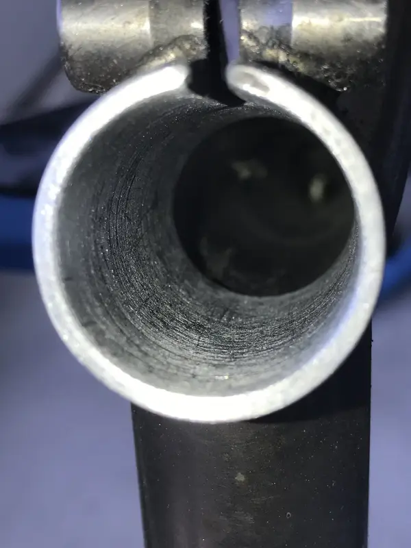

7) The seat post tube was fricking disgusting with old grease that had solidified into a super hard plaque. I had to scrape this out by hand, then get in there with steel wool and scotch brite and chase the entire tube

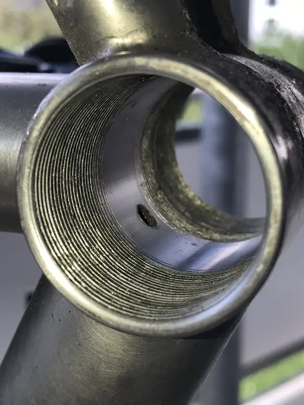

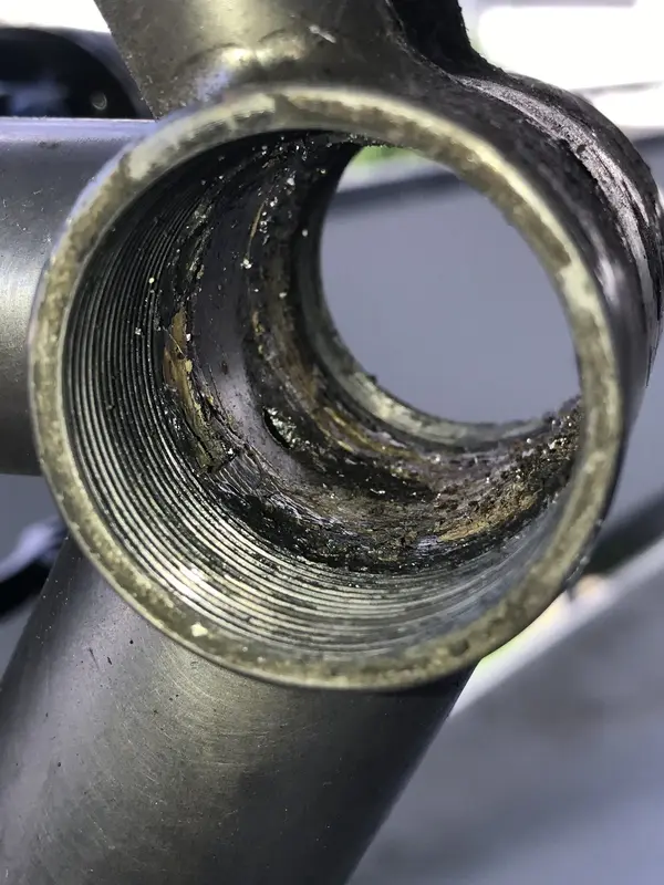

8 ) Bottom bracket housing was completely caked with old greases of various types and viscosity

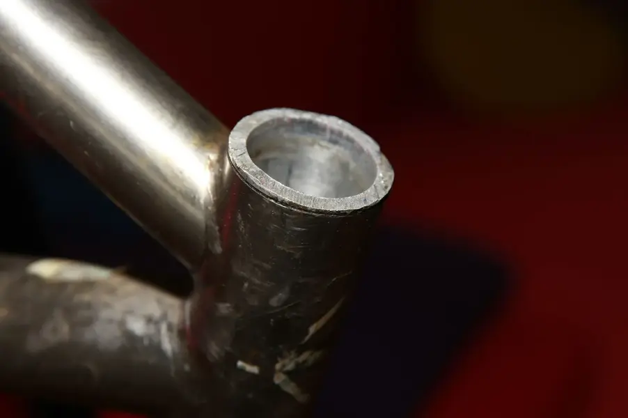

9) The sleeves for the head set are a bit beat. See photos.

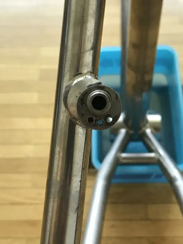

10) The non-drive side rear brake mount bung is crooked. There is no 7 or 8 mm slots to use a wrench to loosen these up to turn the little spring preload plate. Ideas on how to remove the brake bosses?

- Strong Lite headset, totally shot

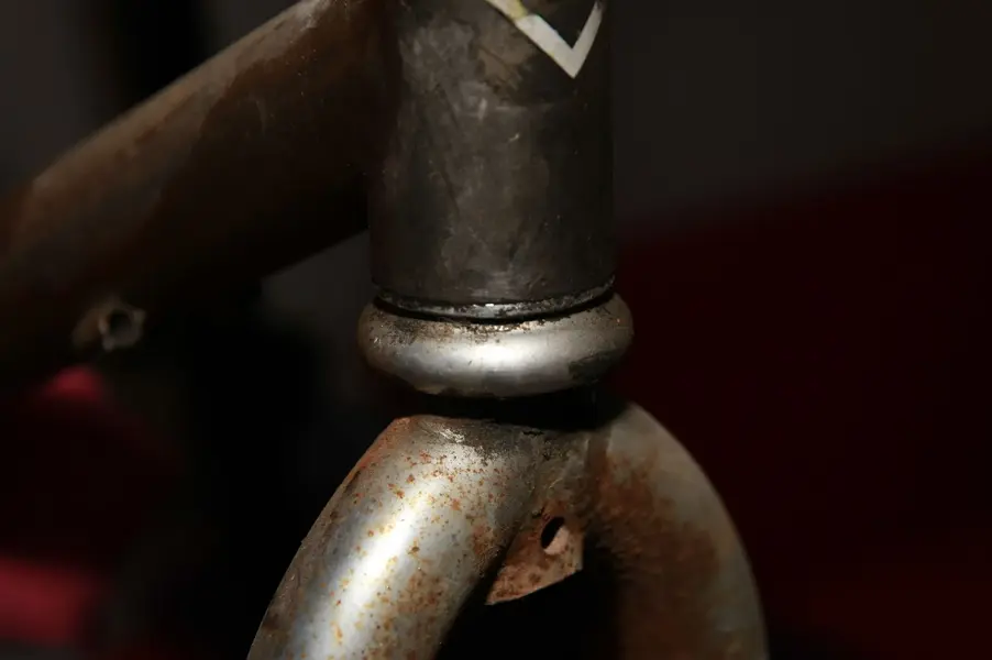

- Aluminum headset sleeves are a bit tattered and will need refacing
- Cable route arrangement
- Crushed cable stop

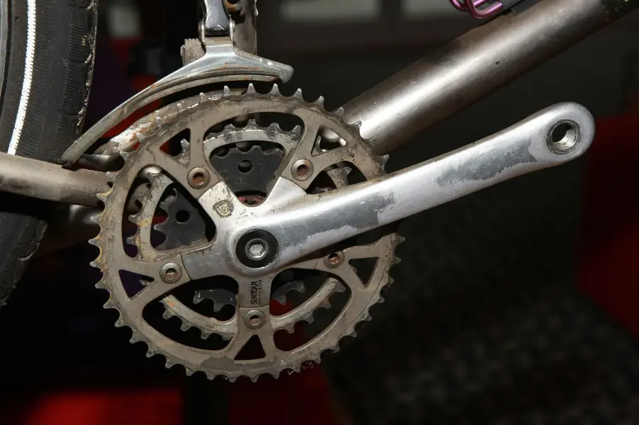

- Old Race Face bottom bracket, 110 mm axle width, cup threads poked out both sides. Bearings still very good.

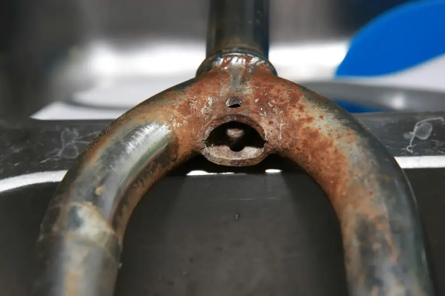

- Tange Cro-Mo fork. In spite of the rust, it polishes up very nicely. 777 grams.

- Tons of gunk in the bottom bracket housing

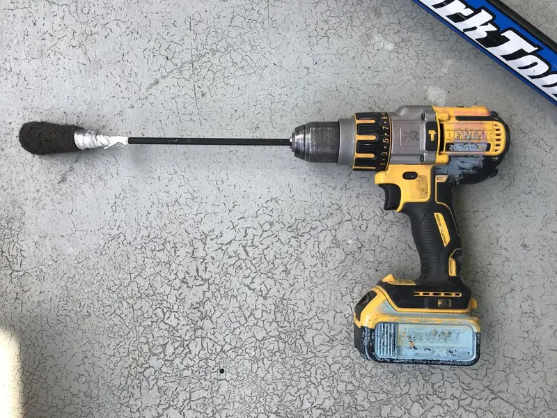

- Seat Post! I tried torquing it out with cheater bars, I tried heat with a heat gun. Had to use the old fashioned method of cutting the stupid thing out 🤬 ;). Always a fun learning process though. Shown below are also the tools I used to extract then clean up the tube internals. Cut off the post with a hack saw or band saw. Leave a nub about 3 cm long. Drill two holes across the diameter. Use those to stick in some kind of steel rod you have to torque the post later. Get your sawsall with a short height blade. TAKE YOUR TIME cutting a groove and check often!!! If you are lucky you only need to cut one grove. I like to cut a grove in line to the pinch grove made by the frame maker to accommodate the seat clamp.
Use channel locks to pinch the seat post together, reducing the overall radius of the seat post. Spray some kind of penetrating oil around the seat tube. Let it sit for a few minutes. Insert your torque rod into the two holes you drilled earlier and start turning and pulling. Eventually you will get that post!

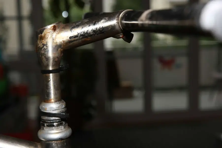

Personally, I would rather look for a replacement of the stem, never liked this Zoom kind of style with widening of the quill towards the top.

- Rear brake boss: In the photo above, the brake pre-load three-hole tab has been spun around and off center. These (titanium) brake bosses do not have notches to accept a wrench for removal. Any ideas? The brake boss is tight tight tight to the frame. I cannot spin the three-hole tab with my fingers and I would like to not mar any metal at all or risk marring or bending.
- Cable routing stop: The top tube cable path has a bent bung. Me thinks I'll use a heat gun and bend that back into shape slowly.
