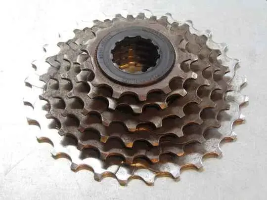

7spd cassette
it will look like the middle freewheel
so looking at that middle freewheel, I see it has threads inside for a lockring.
Am I right?
<puts down morning porridge, sighs gently>
Have you read the text in the picture - its a Hyperglide freehub body with threads for the then defunct Uniglide, dont let them confuse you when you open the packet. <--------gawd he's a grumpy bugger this morning! Nurse!
Depending on the 7spd cassette you have, make sure you have one of these to hand, it can sit between the hub and the cassette if it feels sloppy after tightening up or it sits between the final fixed sprocket and the 7th sprocket if its the old silver/ brown cassette with the brown coloured splined lockrings

Thinking about it, unless you really really must stay 7spd, why not get in there and fit an 8spd freewheel body? They go straight in and unless the hub is 130mm, you just need a redish and some spacer jiggling
oh and wiggling
You can then go stealth 9spd (uisng old mechs) or even 10 speed (using modern mechs)
The hub is 130mm so it's perfect for the clockwork. I'll be sticking with 7 speed.
