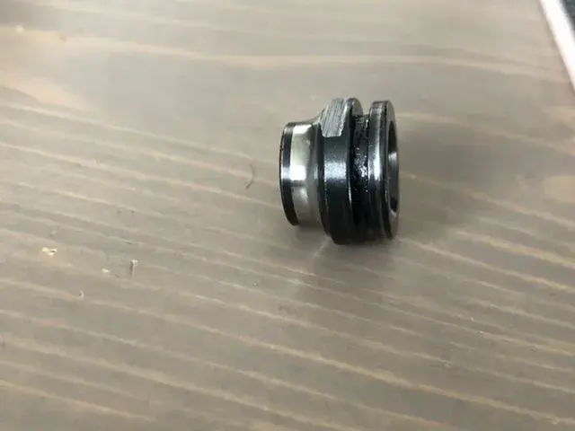

I have been checking part numbers and specs on Shimano tech docs.
It seems as if the cones for each are of a different size - so ultimately using the cone I have may well be a problem.
As I don’t know exactly what freehub body I have - most likely it’s the original part rather than the other compatible one as in SJS.
I am
Weighing my options :
1)To buy one from SJS and the matching cone/spacer set
2) to get the original part freehub body and hope my cone fits
3) to get a Deore MTB Hub and salvage the free hub body and appropriate parts from that - this would probably cost as much if not cheaper than a new freehub body!
What do you think?

The shimano cones are the same size but can differ in how they seal against the freehub (as you have found)
The freehubs with the extra metal washer that covers the bearings can be popped out so you can fit your own system or use something from a different hub
The bearings are all the same size in Shimano hubs going back to the early cassette models - I've yet to find anything different so far.
You may find that bearing cover in your original freehub may pop out and sit in the new freehub

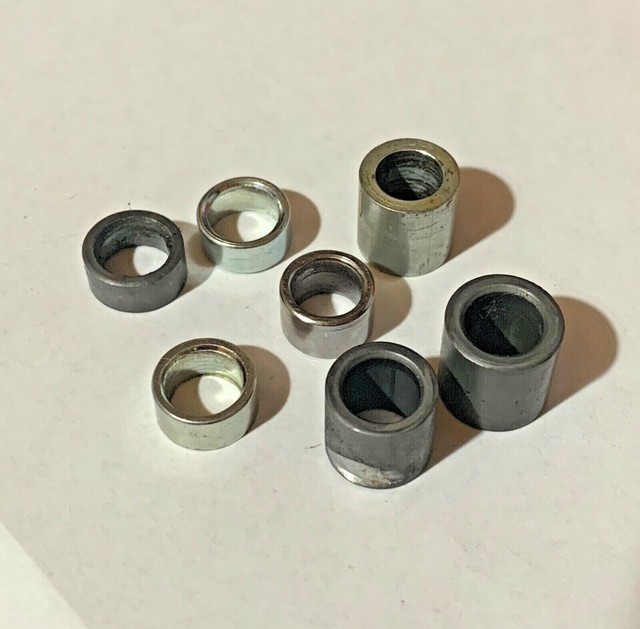

You may find using two of the thin hex nuts found in Shimano hubs and experimenting with washer/ spacers allows tightening and adjustment to be a bit easier

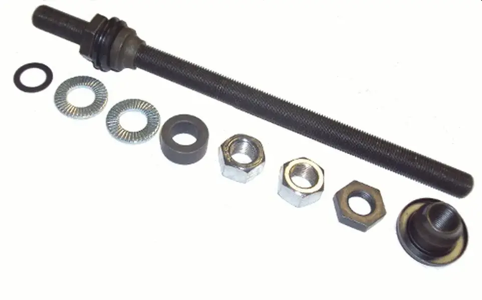

legrandefromage":19rfwqjb said:
those cones were on older XT hubs and some road too
http://dt6110.web.fc2.com/parts/shaft10.html

- that’s interesting - it seems as if the parts are interchangeable - no wonder I couldn’t find the cone to match mine on the tech docs - mine has no spacers so either it’s a custom assembly or specific to this FRam hub.
mine may well have been ok if I’d found a way to secure the cone and lock nut together at the right pressure away from the bearings.
I’ve since changed the cartridge bearing in the off side so now it’s buttery soft and smooth so any friction which may have caused the axle to do what it did - may have lessened - but I can’t still work out how to secure the cone and lock nut

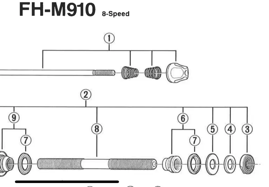

ok, i forgot to check, but have just looked at si.shimano.com , please note i haven't had time to read the other responses
here is the link to the fh-m750 hub, with exploded view, basically i you use the same cone/spacer and lock nut then the drive side should work
https://si.shimano.com/api/publish/stor ... 0-1789.pdf
here is the link to the FH-m756, you'll note that the part code between this and the m750 hub is different, so you really need to be specific as to which freehub you actually have
https://si.shimano.com/api/publish/stor ... -2099C.pdf
FYI the RM30 freehub is a totally different design
here is the link to FH-M615, again a different part code for the freehub
https://si.shimano.com/api/publish/stor ... 5-3513.pdf
basically, identify the freehub you have, if it came in a packet with a shimano label then it should have a part code, something like 3bc9801, possibly with a y in front of it and a zero on the end, sometimes the extra digits are used sometimes they are not.
once you know the freehub, then you can identify the correct cones/spacers etc using the above charts with part codes, if you have any trouble getting them give me a call at my shop and i should be able to get them for you 02380 890712

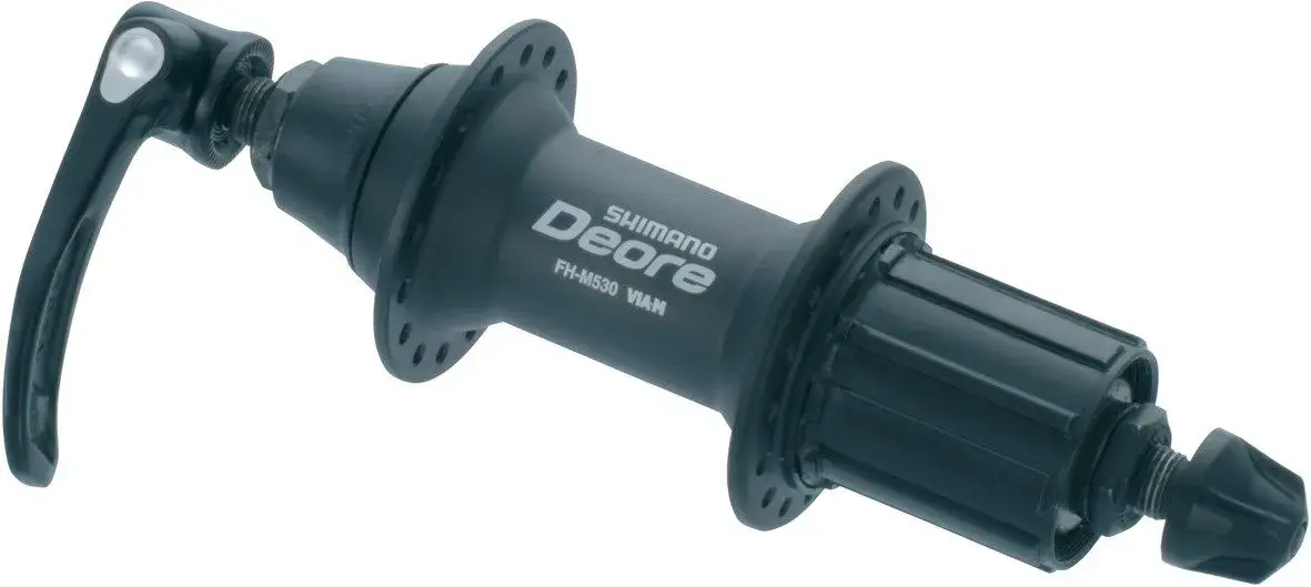

But according to the other posts and the video - the FRM hub is compatible with M530/M525 part number Y3SR98050.
So I’ll need to get one of these. Unless of course a) the new freehub body I have (which looks like the M615 you linked above- but which I’ll need to identify) can work with my Wheelhub - in Which case I find the matching cone and spacers locknut assembly parts as you advised
I’ve realised that the cheapest option would be to just buy a M530/M525 Rear hub - new, and salvage the freehub body cone and spacers off of it - and transfer it over. Can someone pls confirm if this is something which is possible to do effectively?
Essentially you are building half a hub so match the cone and spacer to the new freehub body and you should be fine - so whatever comes with the 'new' hub, use that with the matching freehub body so it all fits then fit it to the hub with your sealed bearing left half.

As for what I’ll do - I am looking for a new M530 or M525 rear hub which I’ll take apart and put its freehub body - cone/spacer/locknut onto the Drive side of my hub. Seems like the safest, quickest, easiest and cheapest option - rather than individual parts and part numbers.
