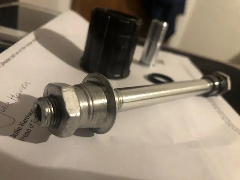

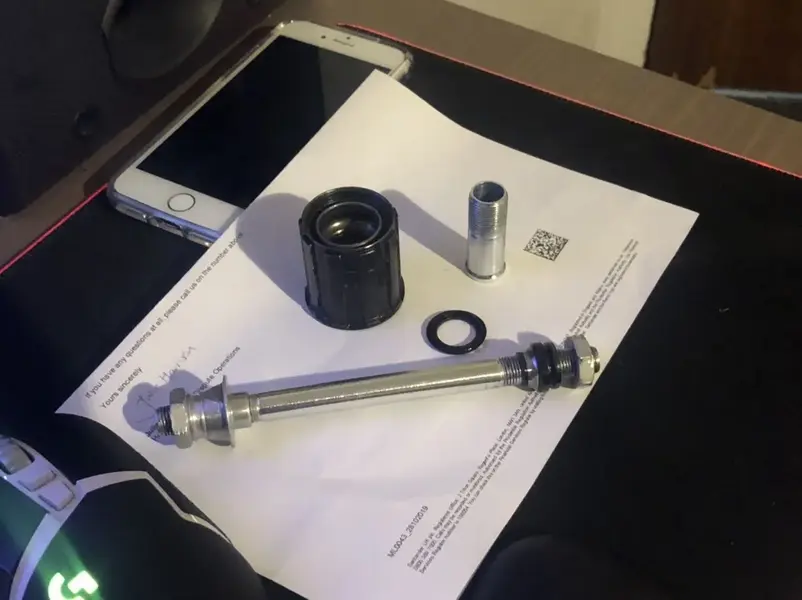

Please can you post a pic up of the axle assembly complete with cones etc. outside the hub?

I’ll do that shortly -

Ah this is not the same as the Italian carbon hub which I had. It's better. On mine there was no adjustment on the non drive side. On yours it appears that there is. Work out with everything loose the position where you have equal amounts of axle shown each side. Then set the cone and nut in the right position on the drive side. Set them solid against each other. Then insert the axle and adjust the non-drive side for play, until you have the right tension in the bearing. Should be fine.

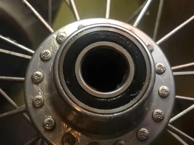

I bought a replacement off side cartridge bearing - which is written here on the dust seal.
He states 6901LLU - I bought 6901RS / 61901 2RS. I couldn’t find a 61901RS as is written on the Seal.
I wonder if they’re all one and the same ? What does the suffix LLU/RS/2RS mean? The first numbers are the same.
Thank you! I shall do so - I think I’ll have to buy the free hub mentioned first and then post pictures here as I do it
