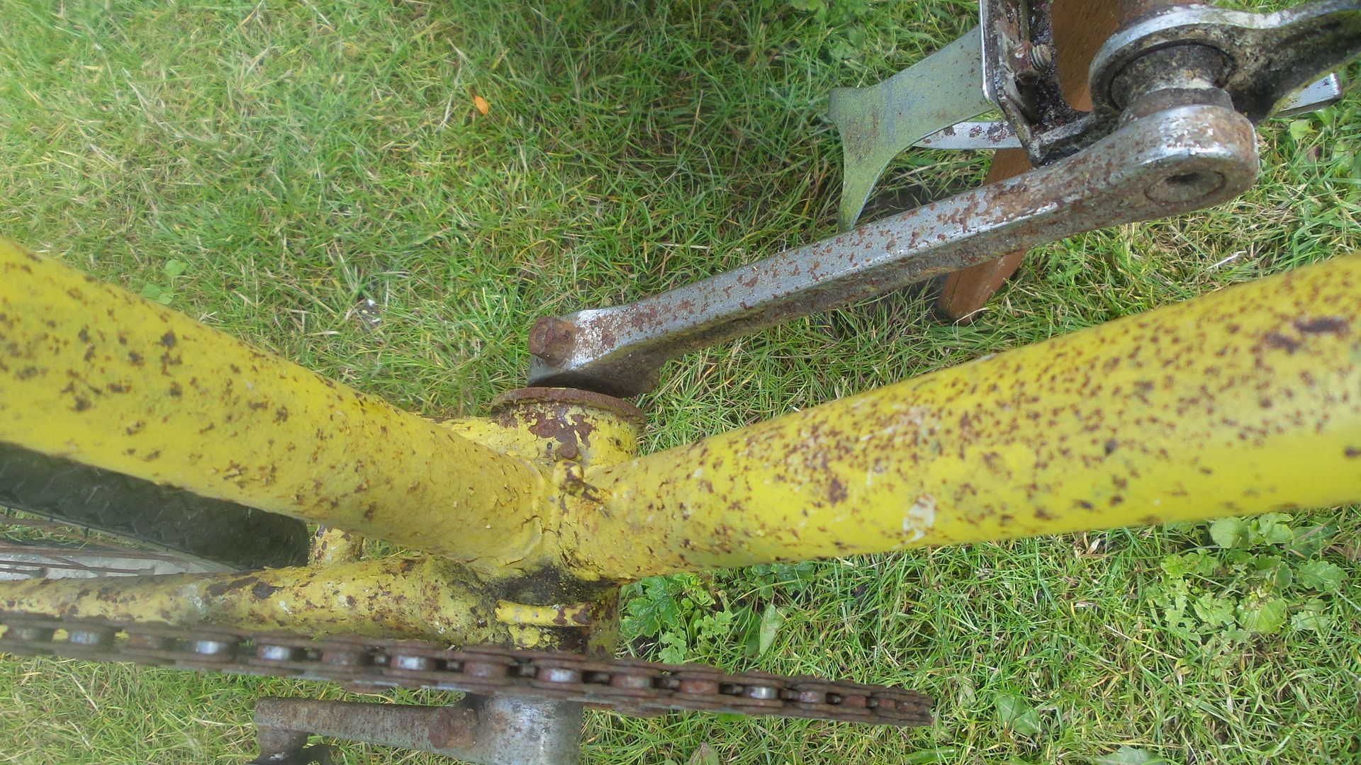

I've taken the frame to Vernon Barker, which is very nearby to me and very well respected frame builder local to me. I've had a couple of MTB frames done by them and the work's always outsanding BUT... By the time the dropouts are straightened, the damage on the crown built up and filed down, then stove enameled with contrasting band, decals fitted by them and clearcoated, there won't be much change from 200 quid... A single colour paint with them is £95.

Yup it's spendy - and powder coating is much cheaper at usualy around 50-60quid. The issue that a powder coater can't fill and flat where the frame has severe pitting, most powder coaters can't do a contrasting colour, or fit decals, repair, apply clear coat etc etc. Sometimes it's appropriate, sometimes not.
thanks, considering the work being done I think the price is ok, though my concern about doing it myself was the durability of the paint and I think with lacquers and self etching primers I can get a paint that won't peel easily anyway, so perhaps for me the money would be better off going into re-chroming the parts that need it
